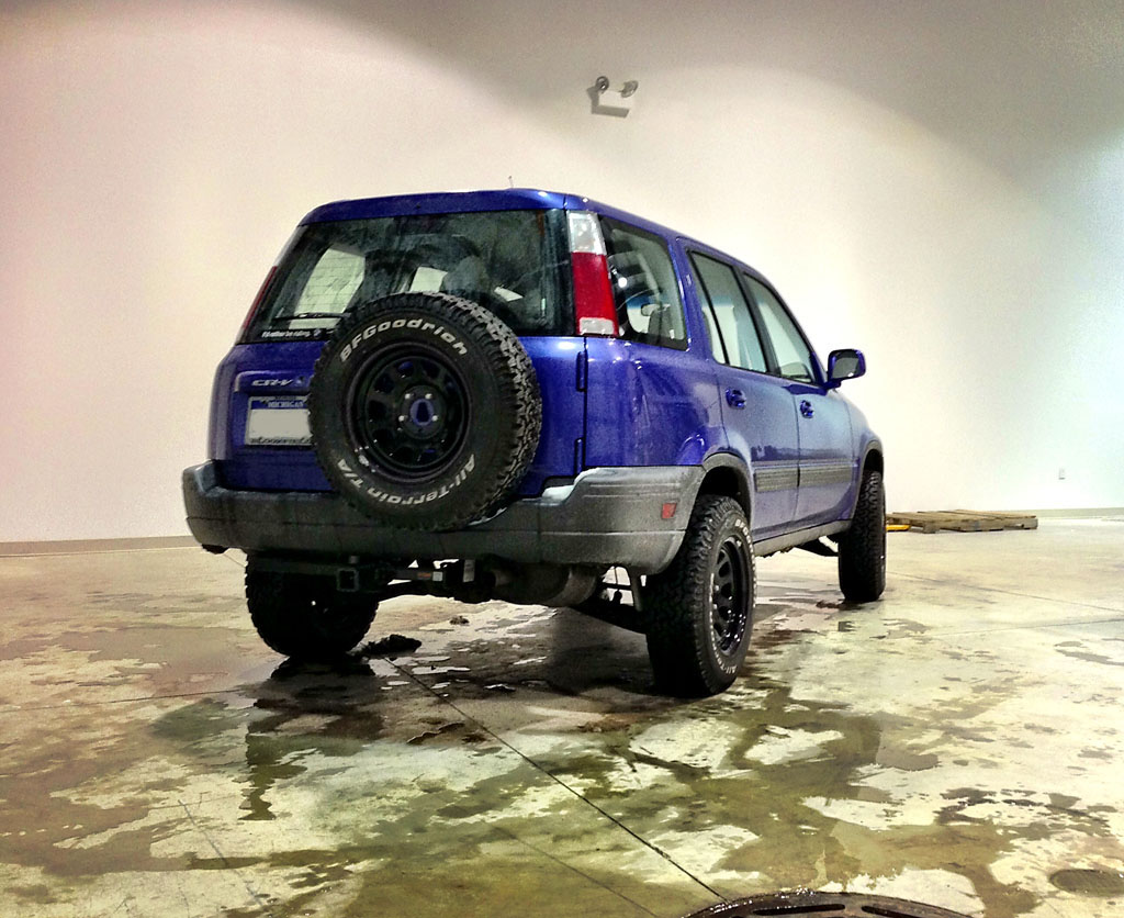

Since the last one was a thread inside a thread, I figured we should start a new one.
-Post up pictures of your Offroad/Lifted CR-V!!
I'll start with mine:
2001 Electron Blue Pearl Honda CR-V
5 Speed
15x7 (0 offset) Crager Soft8 with 8mm spacers
Old Man Emu springs

4cylfriend, did you have the CRV at IFO in ohio Fall last year?
Old 01-20-2013, 11:32 PM
Caddiman's Avatar
Join Date: Sep 2009
Location: Northen Cali
Posts: 5,370
Default Re: *Official H/T LIFTED CR-V thread!*
i want a crv!!! that ebp is sexy

Yep, I was there in Columbus for IFO twice last year. This year I will be a participant
Thanks alot brother. I suggest you get one, there is something about them that makes them alot of fun.

Haha, thought i remembered seeing this their! You had it posted up by the fence i believe. Why i remeber IDK. Ill be out there this year as well!

Haha yep, posted! Must have been walking by seeing, Car-Car-Car-WTFISTHAT-Car-Car, Etc. Haha.
