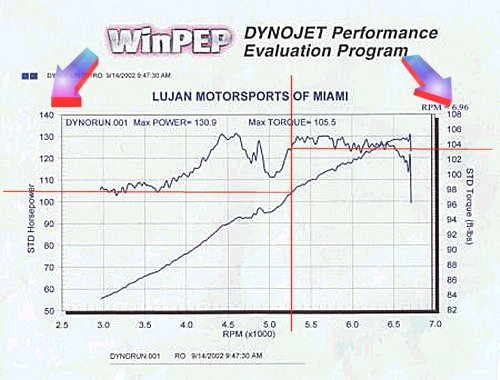

Yeah, that always rattles 'their' cages; the ppl that believe in the Horsepower Fairy...
Now that you have that under your belt, here's a good one for you. Some guy got all upset one time and posted a dyno chart that he thought proved me wrong. In fact, the X-Y axis had been manipulated to fool unsuspecting ppl into believing some lie or another; who knows what kind of larceny they were up to? It gets back to the old "when liars figure" comment above. So, I charted it out for him. This was the result:
Now, look at it very carefully! He said the torque equaled horsepower at 6350-RPM, not 5252, so I was wrong. However, upon careful inspection, he was wrong. Follow the red lines that I drew to the sides of the chart. Horsepower and torque WERE equal at 5252-RPM, not 6350. Someone had just screwed with the numbers on the X-Y axis to make it look better.
What's the moral of the story? Horsepower FIGURES can be manipulated to say anything you want. Torque is the only reliable MEASURE of power output and torque is what you FEEL in a car, not horsepower...
