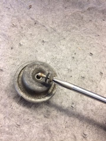

Found this resting in the buttcrack of the Starter and Starter Solenoid. Anyone have any idea what it's for? It's very small; pic was taken on my seat with my phone very close to it. A little short of half an inch.

That goes on the end of the fuel rail where the line from the fuel filter is. There's a small diaphragm in that end piece and that screws in under the plastic cap.

I'd have to disagree with you because the fuel rail/line bolt should have a hexagonal bolt head... well, at least mine does

Let's start with year/model/trim level as there are many options available on 92-00 civic/del sols and it's gonnamake a difference as to what's actually under your hood.
I promise you, this is where this screw goes. I just rebuilt my engine and this stupid screw fell out. Took me a little but to figure it out...
Under that plastic cap. Note: Not my car pictured.
-Amp

Damn if it doesn't look like he's right.
https://honda-tech.com/forums/acura-...0-gsr-2825228/
Still a good idea to post year/model/trim level on future tech related posts.
From literally right now, just in case you want 100% confirmation...
And yes, starting with as much information as possible will drastically help your chances of finding a problem here. I just happen to have done this recently.
A spare one I have. ha
-Amp

They don't look the same to me. On has outside threads, the one on the fuel rail looks like it may be female threaded:
Granted the second picture could be less clear... Hard to say.

I think they are the same. Also, the one that fell out could have fallen out BECAUSE the threads are messed up, which is what it looks like to me.

That's definitely the screw from fuel pulse damper as shown. It always wants to fall out. Usually it's held in by the plastic cap fitted over the damper.

Sorry for the late reply! That's exactly what it was. Vehicle is a 1997 EJ8 w/B18C. Thanks for all the responses!

If I were to guess, i would say screw threads into the diaphragm inside the pulse damper. The o-ring seals the air chamber inside the device from the outside air. Perhaps this allows variable damping characteristics.....when the damper moves only slightly, the chamber remains sealed building air pressure (making the damper stiff), but if the damper moves outward a lot, the o-ring looses it's seal and the pressure build-up is vented (theoretically making the damper softer).
I'm just guessing though.

It keeps an internal spring aligned.

All USDM/CDM 92-95's have that setup on the end of the fuel rail.
The 96-00 did a different fuel rail setup.

I would suspect it could affect how the car runs. Honda put a plastic cap over the top to help hold it in place as well as make sure it wasn't lost should it back out.
slomofo did indicate it helps keep a spring aligned. Without the screw vibration could impact said spring. I'm not exactly sure how the system operates but I don't see Honda putting a screw there if it wasn't needed.

ALL USDM '92-95 Civic's have a pulse dampener on the inlet end of the fuel rail. Now in fairness to those who have a car and BELIEVE that it is otherwise stock... the possibility exists that the fuel rail has been removed/serviced in it's life and the half-assed mechanic/owner did a poor job of replacing the original parts. In many cases, the plastic covers are not re-installed and vibration effectively dislodges the dampener screw and it APPEARS that it was never there. When the car left the factory... it was there. Twenty-four to twenty-seven years later... this may not be the case.
