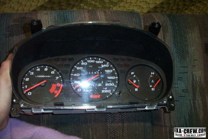

whats the diff between ls cluster and gsr cluster?

im putting a ls cluster in my ek soon and i was wondering whats the diff between gsr and ls? since i was looking to get a gsr but now got the ls cluster....the 95 one...

that's it? both still amber? and lighting is the same?

Yup everything is the same cept for the redline.

everything is the same except the gsrs redline at 8k.

8200 y0!

Redline is 8000rpm.

^That's gotta be the cleanest gsr -&gt; EG cluster swap I've ever seen!

I know we're splitting hairs now, but the redline is 8100.

As people have said before, the GSR has a higher redline. But there are a couple of other small differences:
1. GSR says "Premium Unleaded Fuel Only." The LS says "Unleaded Fuel Only."
2. The LS can possibly be an automatic, thus having the P, R, N, D4, D3, 2, and L lights.
If needed, I will post a picture of my LS cluster.

I've seen the 8100 figure published before but the tach seems at 8k to me. Rev limiter is a whole different story.,
And shamoo, are you sure that the GS-R cluster doesn't have provisions for the ATX light indicators? I say this because Si clusters have them like all other Civics.

I have seen many GSR's and I have never seen one with those light provisions. This is to say I'm not totally dismissing the fact that they could exist here in the states. I just haven't seen them. I doubt it though. Since they don't make an automatic GSR here in the states, I don't think they would have one available.
I was suprised that you said the Si clusters have them here. I wasn't aware of this at all. Are you speaking of the cars with the B16A's? As in this style car?
However, in JDM land (and possibly other lands) where they do have automatic GSR's (called Sir-G's and Si-Vtecs and the like) they may have provisions for the lights in their clusters.
