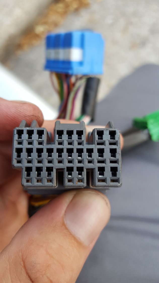

what plug is this?

It was supposed to be an odb2a harness. Does not fit in the "a" port of ecu. The other plugs fit in c and d.

My car is 96 civic ex 5 speed. D16y8. The motor stamp said p2j5, which I heard means the motor came out of a 98 civic auto. My harness, ecu, and dizzy that is in my car is an odb2b. I bought an harness from a guy. I thought it was odb2a because it has the "d" plug. When I try to plug the harness into the odb2a ecu I just bought the "a" plug doesn't fit. The "c" and "d" plug fits though. It can't be an odb2b because it has a "d" plug and not the "b" plug.

Not necessarily true. I have two grey plugs on my odb2b harnesses. And the other one I have looks like odb2a but the a plug doesn't fit.

I want to make it all odb2a because my chassis is 96 and I've heard you will never have your car running right if you don't have the right harness dizzy and ecu that goes with that year car. Well 96 to 98.

You are still not making sense. You just said 99 to 00 have the plug in position "d". I have an odb2b harness in my car right now and there is nothing in "d". And my question about the plug is not even that harness. I have another harness and it has the plug I don't know what it is. I know what the cabin or dash plug looks like. The plug almost fits into the "a" position but doesn't. Though it is closest to firing the "a". Not "b" not "c" not "d" not cabin or dash.

I appreciate you trying to explain this to me. The harness I have the issue with plug "a" won't fit into either one of my ecu's (odb2a or odb2b). The harness that is in my car now (odb2b) fits into my odb2a ecu. If I could figure out what harness I have for the unknown harness I could possibly use my "a" plug from my odb2b harness and put it on my odb2a harness so all three ecu plugs fit my ecu.
