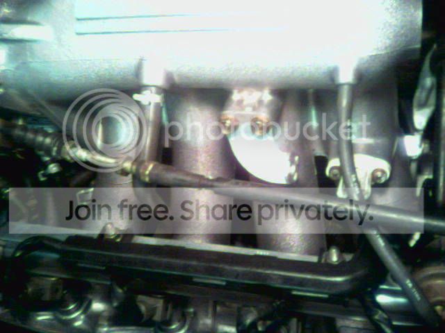

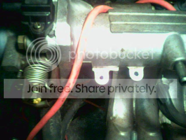

i have a JDM b16a and ive notice that the will not just bolt on is there anything i can do to get it work or do i just buy a new one? and if i do will a 1999 honda civic SI cable work? heres the pic if you dont know wat i mean:
This is the top view where the B16 I/M (Picture Below)
Closer Picture of the B16 where the
Accelerating cable wants to hook up (Picture Below)

You could make a custom bracket or get the throttle cable from the 94-00 Integra or Del Sol Vtec.

probably be easier to make a custom bracket, just cut a rectangular piece of steel at the right length and drill two holes in it where the bracket you have can bolt to the custom one, then bolt the custom one where your other bracket is, make sure to get your measurments right though. I had to do the same thing with my B16 swap.

just turn around the bracket and only use the one bolt on the left, then bolt on the throttle cable. Its a ghetto way to do it but it will work for the time being. Mine has actually been like that for almost a year.

we fabricated a metal bracket to work on my b16 hatch.
