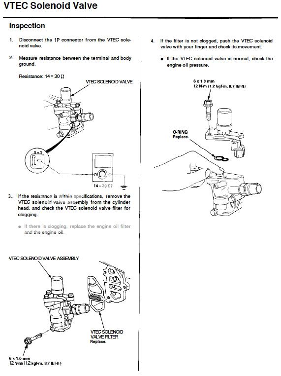

hey honda tech! so, i have a 99 civic coupea ex with d16y8. its is a super clean car that im using as a daily driver. im trying to do some small things to "tune it up" and get it to run perfect. i just replaced the dizzy cap, rotor, ignition coil and plugs. but the thing im not sure about is the vtec, i dont really feel it or hear it, i have no check engine light on but i dont think the vtec is really working.
does anyone have any pics or advice to clean the vtec sylinoid on a d16y8? thanks
