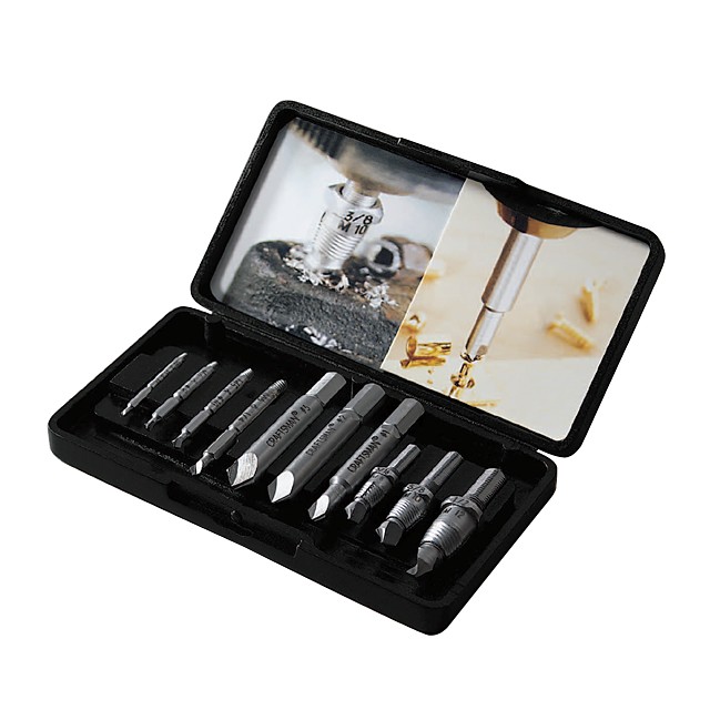

They should have the extractor bit set at your local Sears or Home Depot or similar shops. Autozone might sell the bit sets too and possibly even have a set for that they loan out.
The set should look similar to this:
I have a smaller set, only 3 bits but they work.
