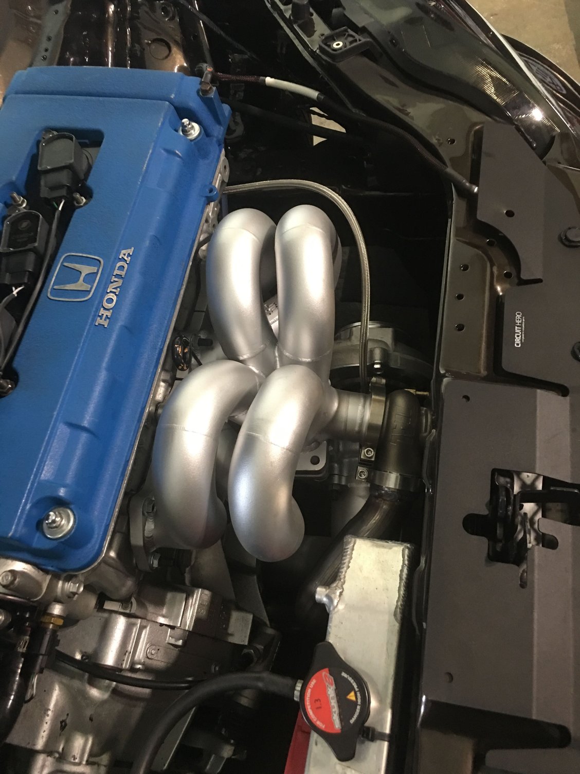

Any update on this? I'm having the same exact issues and just because of the amount of money I have into this built I went ahead and changed a ton of things just to be safe it still same problems. I'm located in Boston MA and our temps are currently low to mid 90's.
Replaced head gasket, water pump, 3 core rad, removed thermostat, added wetter and coolant lines to the turbo and waste gate and I made the fan to stay on.
Takes a lot longer to heat up now but eventually it gets there. Seems like it's long local drives and immediately once I exit the highway from a long enough drive "10 minutes". If I stay on hway and cruise the temps stay at 190-195 otherwise I'm close to 210 and I shut it off once I see it creeping.
Best advise i se I have seen on here is fabricating some duct work for the rad. Seems the intercooler blocking airflow may be the issue but if you know of anything else I'm open for suggestions.
