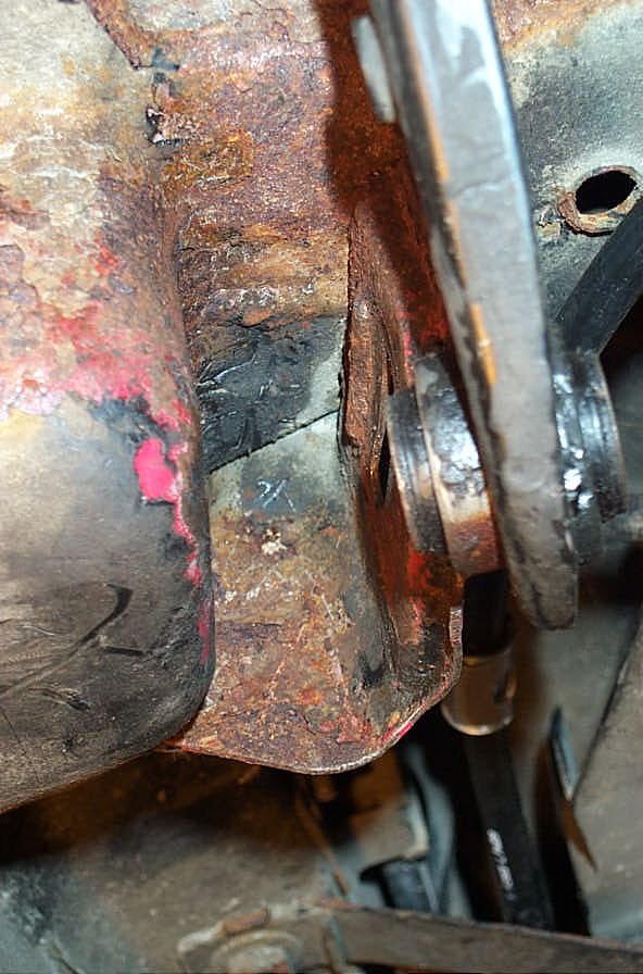

When I took out the bolt which adjusts toe on the left rear, the little plate that the bolt attaches to fell out of it's groove and into the "chassis".
How can I get the plate back in it's groove? Do I have to cut the chassis open? I don't think I can get to it otherwise...
Here's a pic of the area I'm talking about (car is a 92 EG4):

eww god damn kid i would b more worried about everything else in the pic than just that bolt. haha

haha, it's just surface rust.... The pic make it look much worse than it is also.

i had that same problem. i just cut a small hole in the chassis

Alright, I just think I'm going to take a drill and make that small venting whole on the bottom big enough to get a finger or two inside.
Talk about stupid construction, way to go Honda

I Used a pick and was really pasent and careful...no need to drill holes in a suspention part
