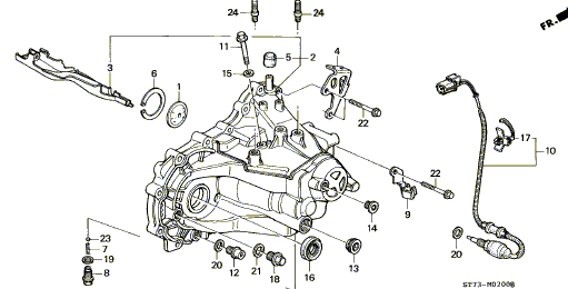

well on the diagram. Number 13 is leaking on my transmission. Seem like I strip the tread inside. It wouldn't go in even. I've try some sort of glue to see if it would seal it in but no luck. I'm hoping there would be another way to fix this instead of me taking it to the machine shop to get it re thread. The screw goes in it's just fine since I [freak]ed up the thread a little bit it's not sealing that good. so please help. I've been trying to figure out a different route then the machine shop.

looks like thats your fill hole from the picture, you can also load up the threads with hondabond, that'll help too

Honestly, since you work at Autozone, do it yourself. You guys rent out tools and stuff last time I checked.
Take a tap and die set home with you. Take out the bolt in question and see what your next best bet would be as far as making new threads.
Go to your local hardware store and buy a bolt to fit your soon freshly cut threads.
Go back home and do your thing. Tranny doesn't need to be pulled out. Just yank off that side's tire. Should give you enough play room in there.
Carefully tap the hole. Drain all the old tranny fluid out to clear out any shavings that may have dropped in there. Might also be a good idea to "rinse" the new threads/hole with some fresh fluid and let that drain out the bottom. Keep your fingers crossed.
Because more than likely that's all most shops would do. They're not going to tear your tranny apart just to make sure no shavings get down inside there.
In the mean time, shoot the bolt and the area around it with brake cleaner and get all the oil off. Blob a decent size glob of hondabond on there and spread it all around. There's no pressure on that bolt, so any oil you DO get from there is just naturally dripping out. Hondabond will form a barrier and take care of that drip for you. It will seal, because the stuff is made to use in the corners of the valve cover. Lots of oil in there.
