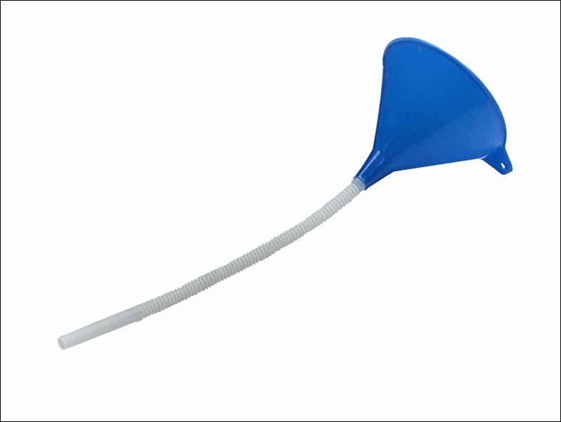

how do you guys get two quarts in there using the fill hole? I never could do it, now I go through the VSS hole.
Old 06-18-2008, 10:31 AM
HT White Ops
BlackDeuceCoupe's Avatar
Join Date: Oct 2001
Location: Arizona Uplands
Posts: 2,813
Default Re: (sorrule)
<TABLE WIDTH="90%" CELLSPACING=0 CELLPADDING=0 ALIGN=CENTER><TR><TD>Quote, originally posted by sorrule &raquo;</TD></TR><TR><TD CLASS="quote">how do you guys get two quarts in there using the fill hole? I never could do it, now I go through the VSS hole. </TD></TR></TABLE>
You gotta use a funnel for an automatic transmission such as:
They only cost a couple of bucks...
Stick it in the tranny fill hole below you lower the car. Snake it down between the intake tube and the firewall.
Fill your tranny, pull the funnel and cap it off!
Simple pimple!!!
