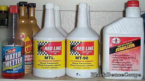

Anyway, to wrap this up - this is what I use and recommend. Don't even bother whith anything else...
MT-90 in the summer and MTL in the winter. Or, MTL year around if you don't live in Arizona...

ok ill agree with you there
redline is good too.

They actually sell Redline tranny oil at my Honda dealer now - that and Neo 7W. Very progressive of them, eh what???

That's amazing! How do they sell the world's "best MTF" for only $5? Red Line is $8...
