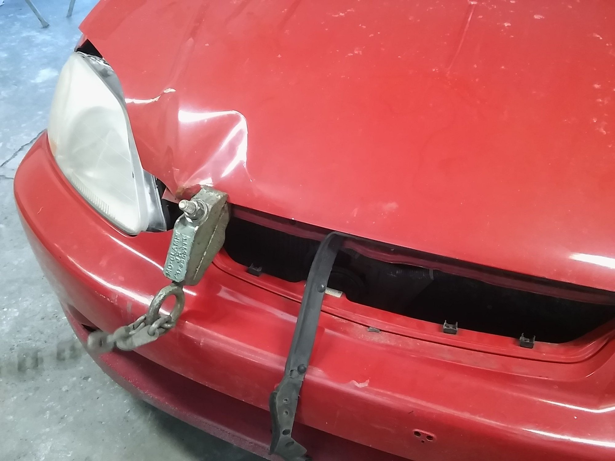

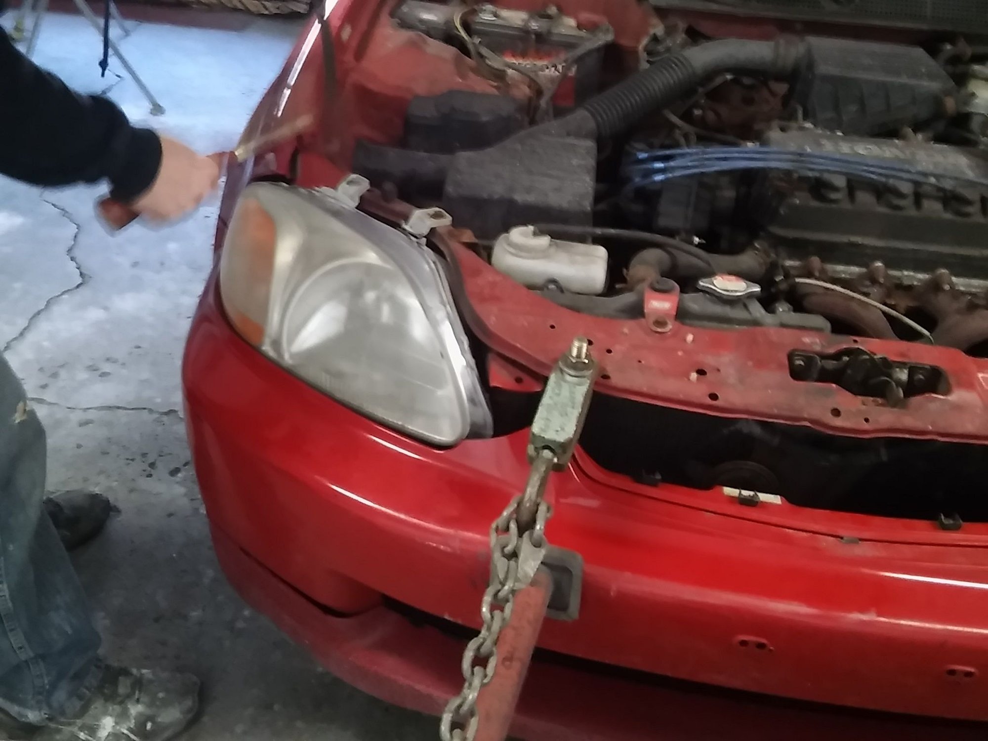

I'm SOOOO butt hurt and salty right now. It's embarrassing but I can't deny it.
My pops has ~40 years of paint and collision repair experience. Yes, they're specific to collision repair. The clamps are so cool. The clamp eyelet is attached to a wedge that's positioned behind the bolt holds the clamp together. As you pull on the eyelet, the wedge increases the clamping pressure of the jaws. So simple. So cool. Less than 50 lbs of force on the end of the pipe pulled all the damage out and hammering the pinch points relieved all the residual stresses.
If I were writing a post mortem on how/why your post was seemingly ignored I think it'd go like this:
"This repair work is so far beyond the normal DIY person that he has no idea how to respond. Most of us aren't sure what we're looking at."
Anyone can replace a hood prop clip LOL. A lot of them are broken too.

Welp...as the offender, my apologies!
I'll be sure to be a little more fair with my replies in the future, and be sure consider level of effort before replying
That being said, I too noticed the tool with the eyelet and wondered if they were collision repair tools- figured they must have been. Cool that you've learned some of the techniques and have access to the tools presumably from your father. Looks good man!

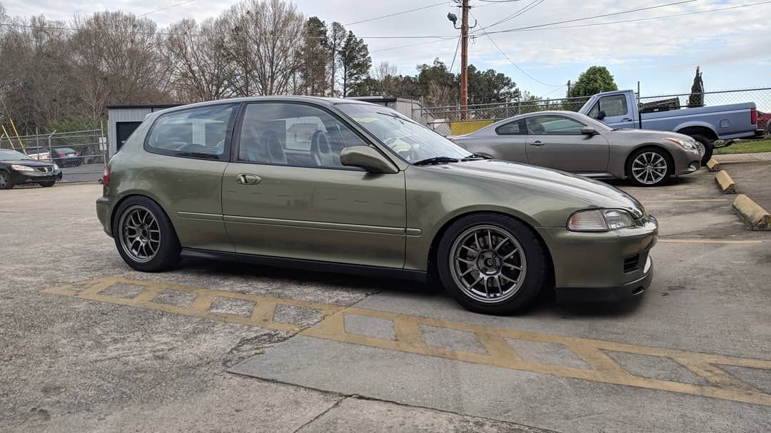

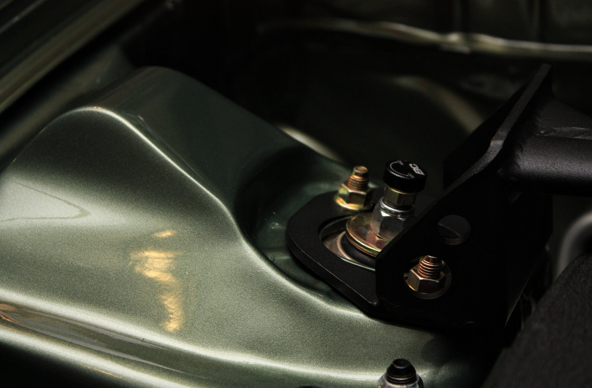

Installed the new strut bar. Front rotors and pads are up next. I have to get the rotors re-drilled to 4x100 first though.

Hot

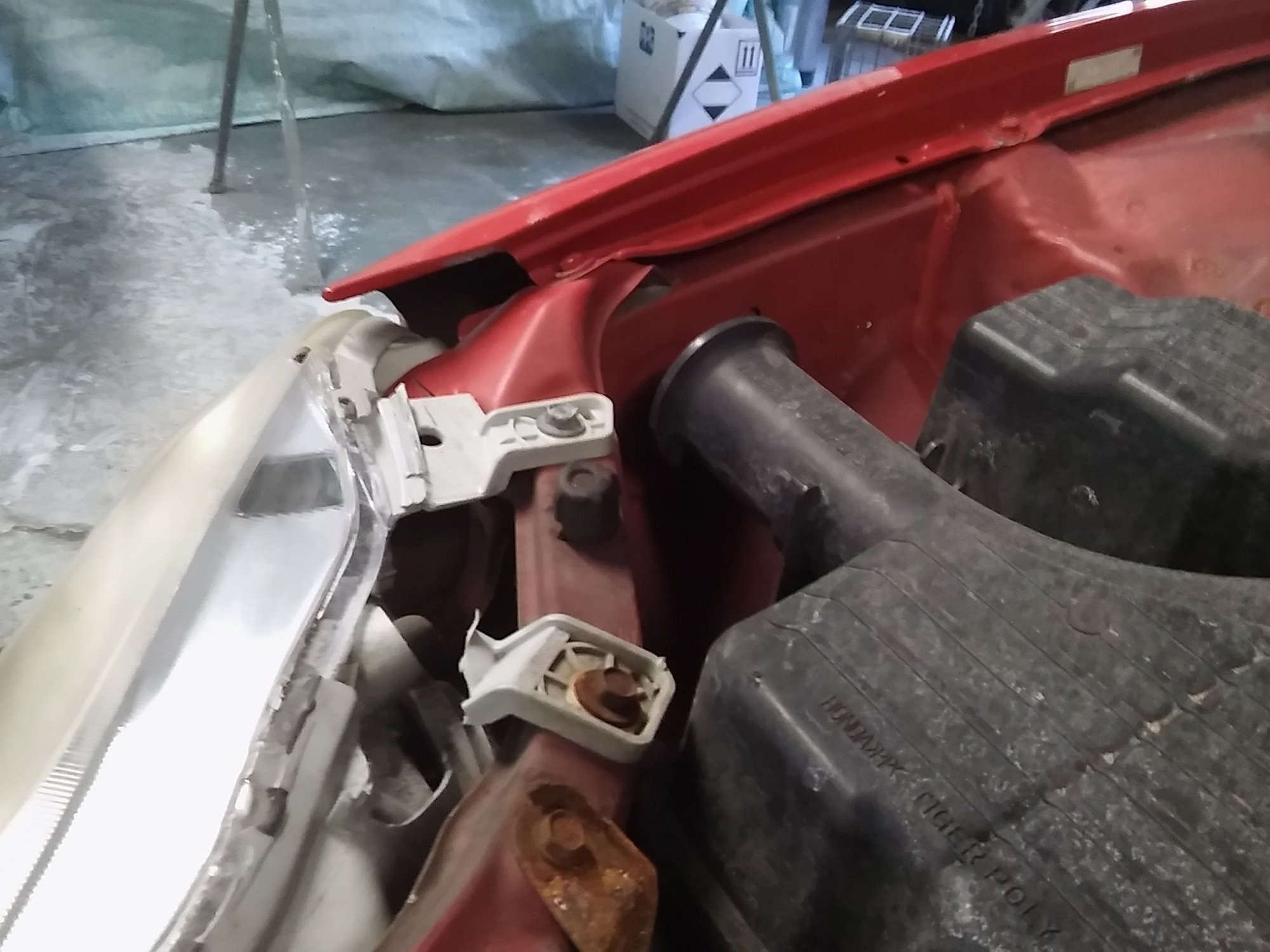

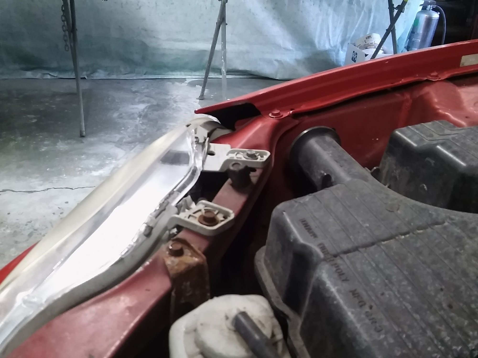

Originally Posted by CX-Adam
ISO 96-98 headlights
Put a bag of frozen peas on War Hatch's eye from it's fight with the Rav 4. ~1.5 hours of work.

^^ This times five thousand...
The most we ever did was a chain around a tree to the frame part needing some "readjusting" on the beater, then backed up hard to pull out the bumper frame.
No where near the class of work or the quality of tools at your disposal. That was some sweet display there!
That's the way you do it!
I can finally see pictures.
Hope they backed into you...
