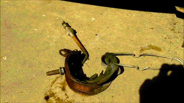

Has anyone done any black oxide phosphate coating of bolts?

here you go, I usually zinc plate though

That video prompted the question, Tony.
When you zinc coat/galvanize, do you do anything to clean up the threads?

Zinc plating took alot of time because I had to get red of the rust by using white vinegar and sat for 8hrs, once I did that I had it in a tumbler for another 6hrs, after taking them out I cleaned up the threads with a dremel and wire brush or nail to get rid of the cleaning material that was stuck in the threads, than zinc plate process and wire brush again for that shiny zinc plate.
The db7 group thread should have an image of my work. I had to do them in batches to
1. organize where the bolts came from
2. because I only had limited space
I couldn't do the same for the tacoma though because there were so many rusted/corroded *** bolts and it pissed me off that I had someone tell me that the truck was well maintained when in actuality it wasn't.
