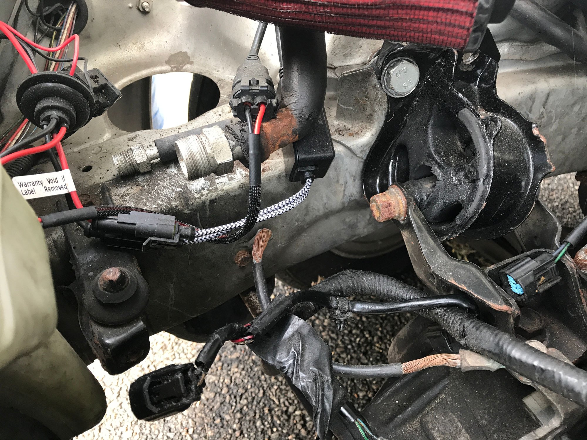

I need help, i bought a Coupe that has a Z6 swap from a Y8 why I dont know. But it was an auto now its a manual and i need help with the mount for the transmission and the mount that goes on the frame to the transmission thenones their are buggered up and not right.

So what help do you actually need? Im not understanding your question. All I understand is the mount for the tranny and the bracket thats welded on the frame has a problem. But what type of problem?

Sorry egdro what i need help with is where to get the correct brackets. They used a auto bracket in the trans and the manual on the frame part. Here are pictures picture ine is the bad mounts. The incorrect mounts

96-00 D series manual T bracket.
the bushing doesn't matter if it came from a 5spd or auto.
It also looks you are missing are bolt.

Oh ok thank you a t bracket that's what i need i got the torque mount and the auto t bracket is different it doesnt mount up right. Thank you 98civex.

You need the rear "T" bracket and the upper transmission bracket from a MANUAL '96-00 Civic EX.
