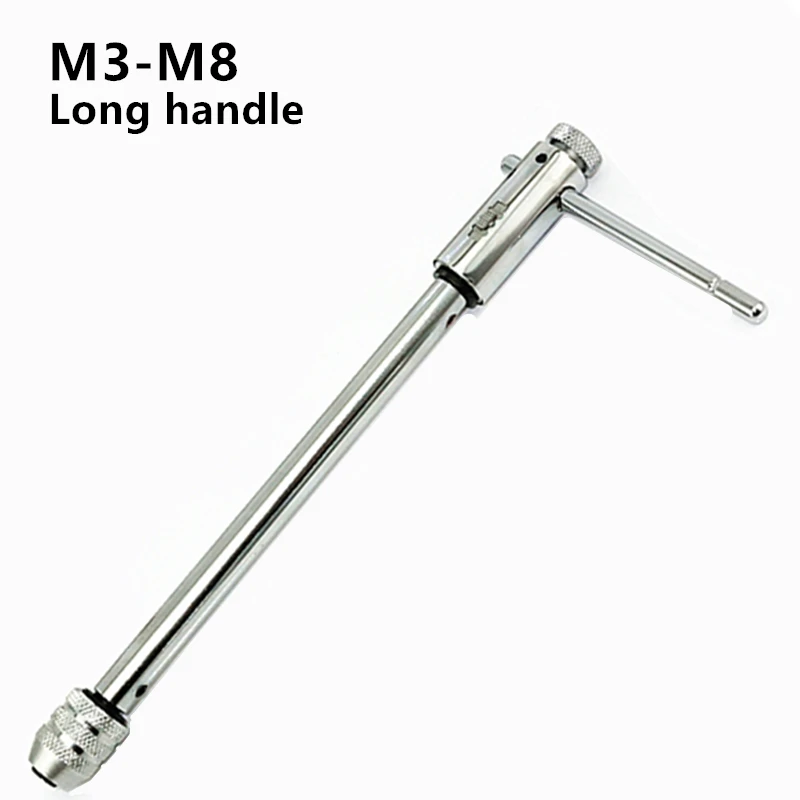

Purchase a thread tapper extension Find the correct drive for the top of the thread tapper (example: 1/4". 3/8" or metric equivalent drive). Can purchase a ratcheting style too as shown in link: https://ae01.alicdn.com/kf/HTB1vHk9K...ension-rod.jpg
Another way (at your own risk) is using a socket extender as shown in this pic: http://nebula.wsimg.com/1b55e1dbf256...&alloworigin=1 However, you don't want any wiggle room between the top of the thread tapper and where it connects into the extension when cutting the threads into the cylinder head.
