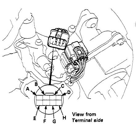

Hey guys... It's been a while since I've posted... But ever since I dissasembled my distributor to replace the coil my CEL has been on... Well soon after I replaced the coil I had to go back in and replace the coil again (due to the first being faulty), rotor and the cap. Well the CEL is still on. I pulled the code and its #9 for Cylinder position sensor. I don't have a way to check voltage or anything but was wondering if it's a common issue? If so how can I fix it? I've already did the steps to reset the ECU by pulling ECU fuse along with the backup but it still came back.

Remove the 7.5A hood BackUp fuse for 5 minutes. Does code 9 return?
If so, you only need an inexpensive multimeter to troubleshoot the problem with Ohm tests.

Measure resistance between pins B11 and B12 in ECU connector B, and also continuity to body ground at each pin individually.
