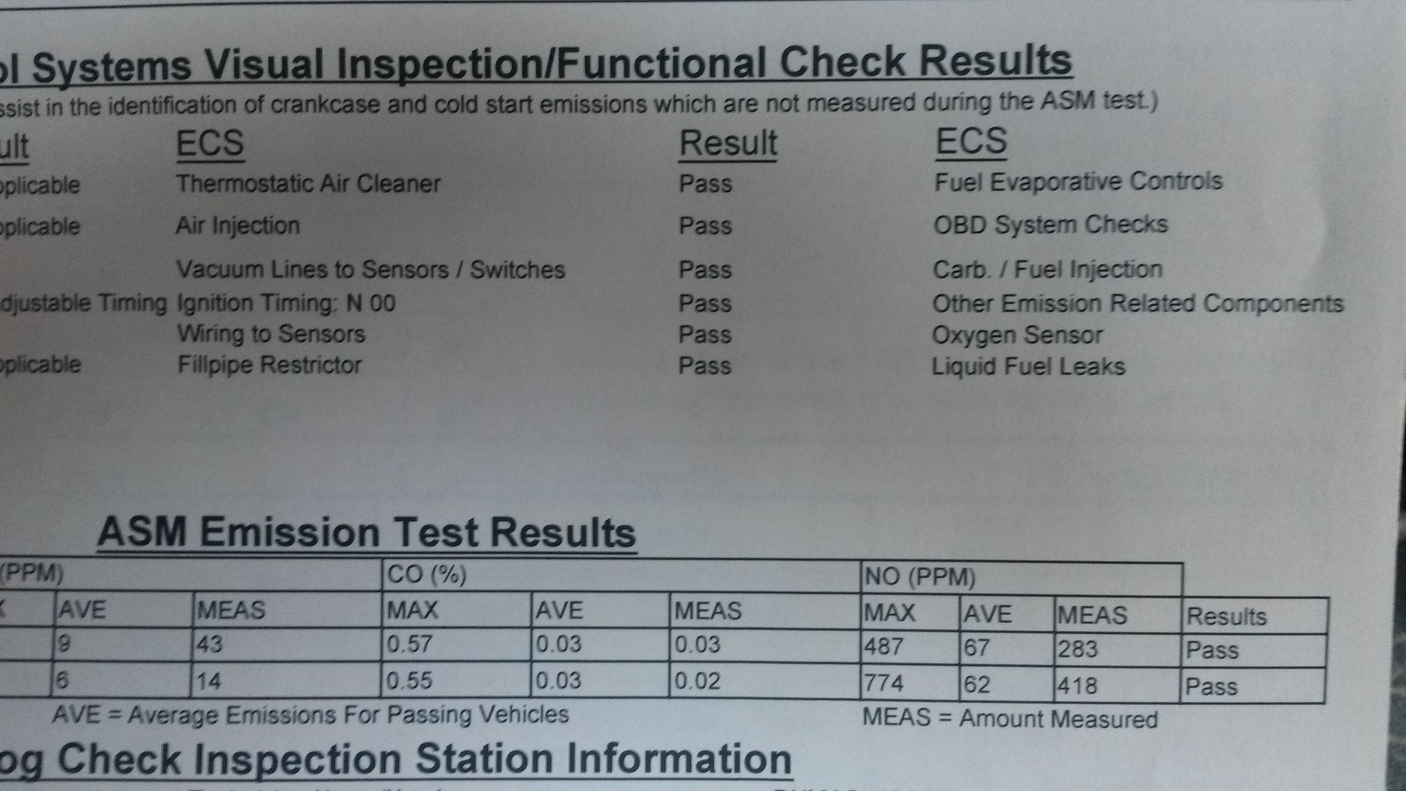

Ok guys I have been continuosly trying to improve my emission due to CA smog. I have done almost everything I can think of what to bring the NoX down. My HC and CO are fine. My car runs smooth, idles smooth, and idles at the right RPM. It's a 5 speed manual, 259K miles there is no EGR on this engine. No CEL also.
As you see I'm failing at 15mph but passing 25mph in NoX I don't understand why its running lean.
I've checked my ignition timing 12 BTDC, Throttle body sensor(functioning/backprobed), fuel pressure from fuel line is 60psi(before the fuel filter and with engine off) the fuel filter has been replaced two years ago; fuel injectors are 12.5 ohms as they should be; Checked for outside vacuum leaks with carb cleaner spray(haven't ran vacuum gauge to it yet...) Not too sure about my map sensor since it's reading at 4.83V(while the engine off) also to note that this is tested through two wires from the connector and also the power from connector to the battery.

Okay guys and for you Ron as well. I passed the emissions! There could be 4 different variables of why it was running high on NOx...
I've replaced the fuel filter from Wix(2 years old) to a Duralast. I've did the correct methodical testing procedure with a banjo adapter too pressure gauge and this time it's after fuel filter got readings of 44-45 psi without regulator vacuum line attached; 33-34 psi reading while vacuum line is connected.
Coolant reservoir was basically empty however the radiator was topped off anyhow stupid as I was it could have possibly made my NOx go up. But it strikes me and now it makes total sense that the coolant temperature sensor is only there to tell me the average cooling temperature from temperature gauge not if there are any hot spots.
Third, of the nit picking was my very recent(3 weeks old) O2 sensors were Bosch. I've replaced it with a new set of two NTK O2 sensors after researching they're more sensitive in readings (and OEM equivalent).
Last of all my ignition coil died and had replaced it with Accel coil. Because I was cranking the engine for dry and wet compression to see how well my rings and cylinder bore walls are doing. I've been cranking the engine too many times since my sparkplugs were getting excessively soaked with engine oil. Took me almost five times to get them dried up. I've only used a tablespoon of oil as the book says 1 tablespoon of oil. And I was very particular with measuring it with a measuring tool like making homemade food measuring ingredients.
What could be the culprit I ask???
Thank you all for your time.

glad you got it passed. i never use Bosch anymore unless im not going to drive it very much or going to sell it. my moneys on the O2 sensors.
