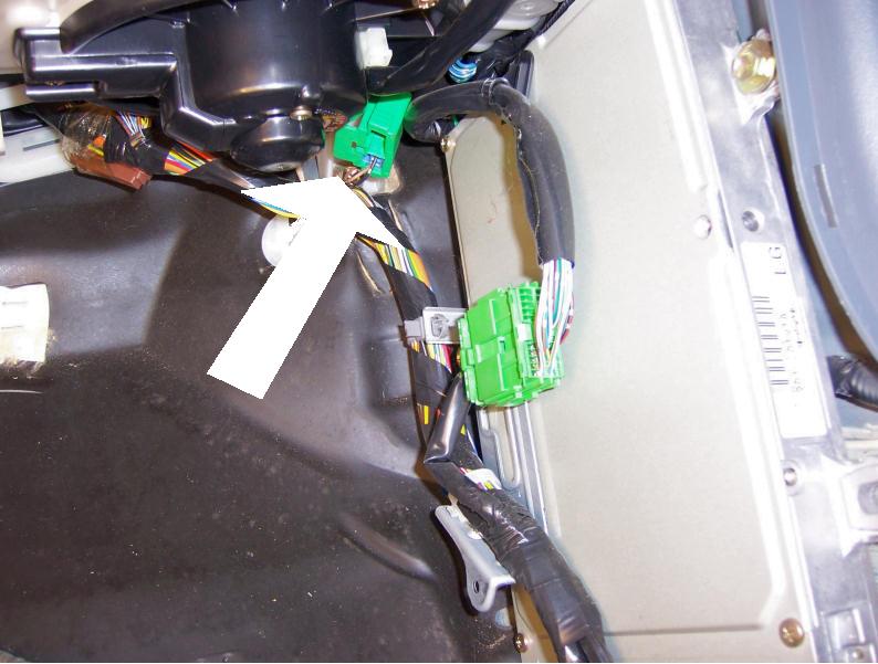

Use my DIY thread at the top of this forum..
Check the code
Fix the code
Pull backup ECU fuse in the underhood glove box for 3 mins.. or disconnect the negative battery terminal for 3 mins

Default Re: (eghondasforlife)

mine doesnt look lie kthat.....there is liek a thin brick looking on top of the ecu and there is a plug of some kind pluged into it but its all taped up....and its a lot higher that the plug in the pic

this was just covered a few threads down.
https://honda-tech.com/zerothread/1706759
and as far as fixing the code goes. the code tells you whats wrong with the car. you then fix the problem with the car and the cel will dissapear into thin air......

isnt that pic from a 97 civic dx
