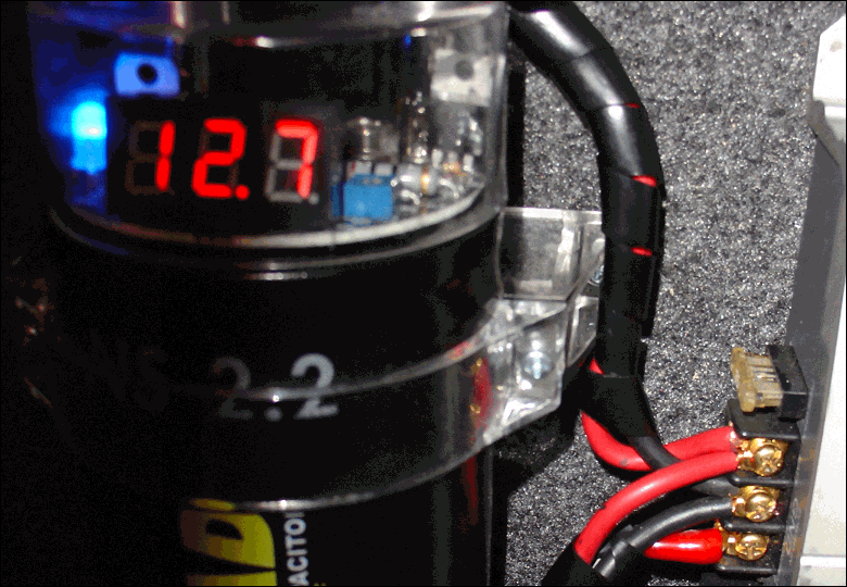

This is kind of off topic but do you have a CAP(capcitor) for your amp? Check and see how many amps(not watts look at the fuses) the amplifier draws, for every 100 amps you draw it is recommended one farad for the capacitor(100 amps drawn = 1 farad CAP). This in turn will keep you from having to replace the battery and alternator as often.

Are you talkin' to me or the OP?
I have a 2.2 Farad CAP in my B16A2-EJ7...
