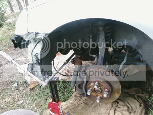

I know it's been covered throughout the forum, but I though I'd refer to this again. Hopefully this will help those who are removing their pulley.
Tools used:
50mm Hex Honda Crank Pulley Tool
Jack Stand
17mm 1/2" drive socket
2 Extensions
1/2" Breaker Bar
2 Pipes, 1 to fit over Pulley Tool, and 1 extra long one for the breaker bar(not shown).
Note: If you don't have the pulley handle like me, then you would need a pipe big enough to go over the pulley tool. If one has the handle, then only one long pipe is needed.

wtf..u make that so difficult i do it with a deepwell 17mm socket and a walmart breaker bar. u remove the flywheel cover and stick a screwdriver to wedge the flywheel.

i must not have lodged the screwdriver in well in my case. this seem to work the best for me. many others have done it this way too!
