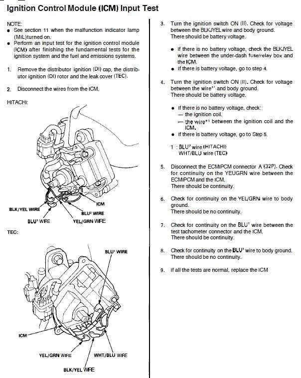

Chances are if it's completely dead the coil or igniter has failed. Both are very easy to change. The coil is pretty cheap, the igniter isn't, but they're easy to find used in a junkyard.
Are these valid diagnostics for coil and igniter? I think they swapped an OBD1 dizzy into the '96 B18:
Yes. Also OBD1 and OBD2 D and B series distributors are all basically the same inside.

Quote:
This was cool that I finally got some time to play with the Civic!
I figured out I have a TD-44U TEC distributor.
My previous distributor had a bad coil.
Putting this here for future references - replacement coils for many Honda distributors @ $19.99: New Honda Accord Civic CR V Acura Integra Distributor Internal Ignition Coil | eBay
