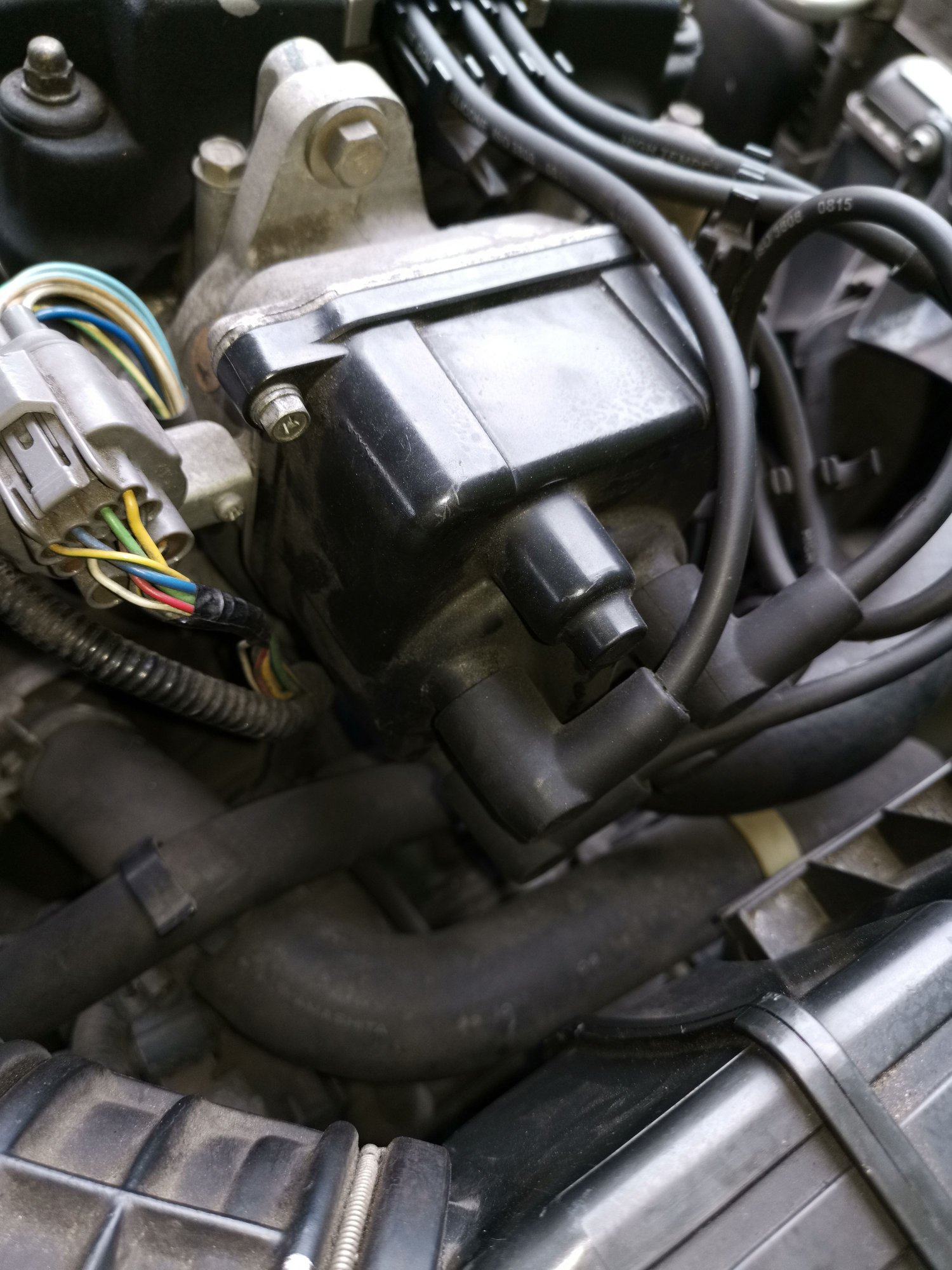

I've also checked over the condition of the Dizzy cap and distributer itself and visual inspection looks good, no cracks leaks, rust etc.

Also clean the heavily corroded points or just replace the cap.

Misfiring at low rpm and heavy throttle is usually weak sparks.
I would try a set of spark wires on it. What is up with that wire that is about a foot too long? That is not a hallmark of a quality set.
The cap actually looks serviceable. Use a knife or screwdriver to scrape off most of the corrosion and get down to bare metal. It's a common misconception that those "contact points" need to be squeaky clean. Actually, the rotor never touches them. A spark jumps from the rotor to the contact every time. Look for a cap with brass "contacts" instead of aluminum, they last longer.
Yeah so the spark plug wires will be my bad doing. I replaced them over a year ago. And looking at the different lengths when the arrived in the box and measuring the distance from the dizzy cap point to the corresponding cylinder this was the best way. However one wire has to stretch over the dizzy cap to fit which I don't link but their was no other way of arranging them and been working fine like this up until a month ago. since this reply I have ordered a new genuine Honda cap and rotor replacement. However to get the rotor off the screw has to be lined up with the hole to disconnect. If it isn't how do I re align the rotor so that I can get access to the screw to take it off and fit the new? Thanks

Sounds like the plug wires are bad and allowing spark to jump to ground in the engine bay. Replace them.
I find the easiest way to work on the distributor is to remove it entirely. You can draw a mark across the top of the distributor to the head to preserve ignition timing after reinstallation, but check the ignition timing with the timing gun anyway because I will assume that you are not absolutely sure the timing is currently correct.
