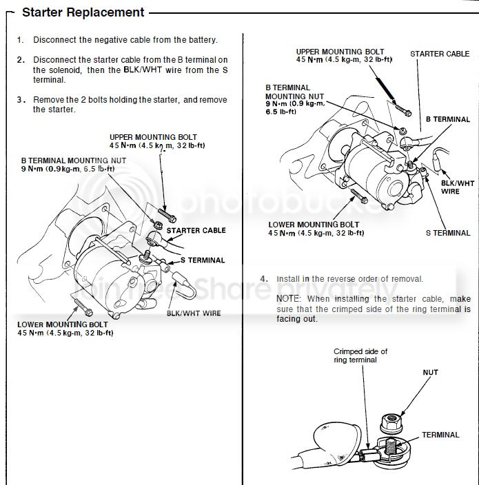

Ok i just put my engine in my car but its not turning over. I hear like the starter is getting electricity but no turn over. There is this wire that I dont know where it goes. If anyone could help me out and tell me where it goes that would be helpful. TIA

Old 11-28-2009, 06:42 PM
Jdm John's Avatar
Join Date: Jul 2009
Location: The cold and wet state of Washington
Posts: 165
Default Re: Quick wire question help!
Hooked up + battery cable to starter on big bolt. Inserted the other black cable.

Old 11-29-2009, 10:07 AM
96_cvc_b16's Avatar
Join Date: Oct 2008
Location: MIDWEST
Posts: 107
i'd say to double check that you have both of these wires on the starter.
