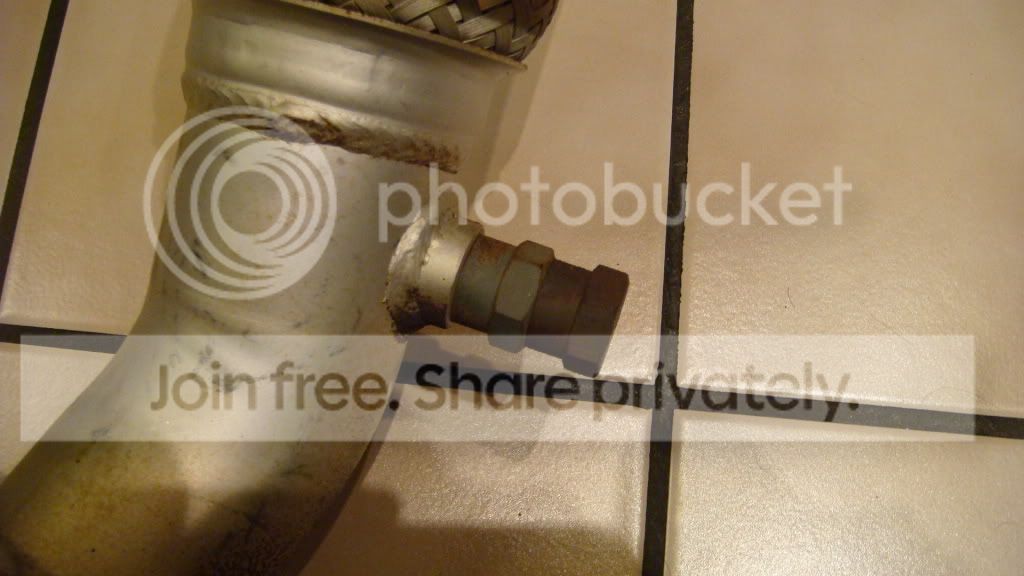

To do it "correctly", youll need the following
$50 eBay header
$15 o2 extension harness; also on eBay
$10 o2 defoulder; also on eBay
-Install the header
-Get a 7/8th o2 sensor socket and move the primary o2 onto the new header; usually on runner 4
-Put the defouler on the header's secondary o2 bung
-Install secondary o2 onto that defoulder
-Connect the extension harness to the secondary o2 plug and the engine harness
Done. If dont correctly you wont have a CEL. It seems like a lot but its not, and you shouldnt spend anymore than $80. With the extra $300 you wouldve spent, get new tools. Make sure you use a socket so you can torque it down enough. I used a wrench and then my o2 fell out.
This is what a defouler looks like, it basically puts the o2 sensor farther from the exhaust stream to trick it into thinking it has a catalytic converter.
