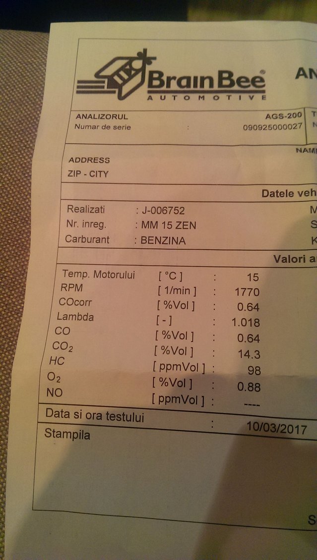

Re: Poor MPG D15B7
Hello, I`m back
The problem is still there.
What I did:
Removed the injectors and cleaned them, changed the o-rings, injectors are fine, no leaks.
I tested the compression, cold engine: 150 Psi; 152 Psi; 151 Psi; 150 Psi;
Failed a smoke test, this is the result:
Not sure why the test machine was reading the engine temperature 14 and 15 degrees, the engine was at operating temperature and running 5 minutes before test.
According to Autodata this is what I should get:
No headers leaks as far as I can tell.
To be honest, I do not know what I should test now...
Thank you!

Re: Poor MPG D15B7
Ohm test the ECT sensor. If the ECU really thinks the engine is 14 C, it will be in open loop mode which means it runs it rich, resulting in high emissions and poor mpg. It is only supposed to do that until warmed up, then switch to closed loop where it uses the O2 sensor to lean it out. Along those lines also make sure your thermostat is OK (not stuck open) and of the stock temperature rating.
Fuel pressure should also be checked. If the vacuum hose on the regulator is not hooked up, the pressure will be too high and it will run rich.
