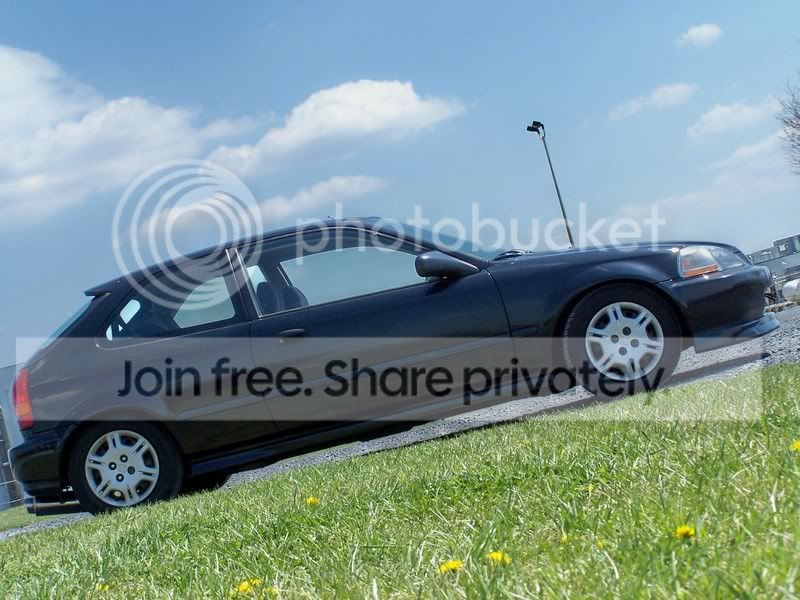

i JUST painted my side moldings and some ABS type r lips. Wash the part. Sand it with 600 grit sand paper. Wash it again. Hit it with an Adhesive Promotor/ Tie coat (most paint shops have it and its not TOO expensive). Follow the directions on that, it says maybe 2 medium coats 3-4 minutes apart. Wait 15-20 minutes afterwards and then paint. All paint varies but I did 3 light coats and it came out perfect to factory.
heres a few pics of the painted lip and sideskirts.... still need to do the side molding, but am contemplating just getting the thin jdm side moldings.
