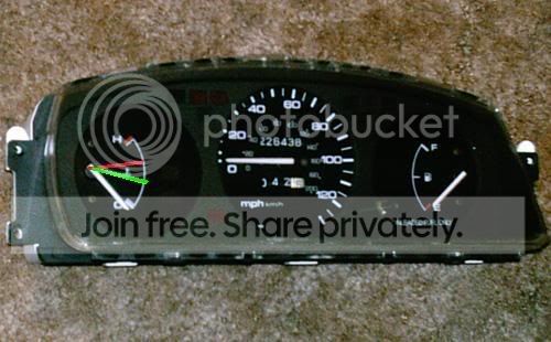

this all started last summer when i first got my si hatch and the upper rad hose got a hole in it and all the fluid came out and my car overheated.. we got it fixed but then today after a lot of driving i stopped at a drive through and noticede my temp was higher than normal could this be due to that overheating all that time ago ..? as soon as i started driving it was good again but i stopped to drop off my girlfriend and it started up again.. heres a pic to show kinda what im talkin about green is where it usually is and red is where it was tonight when i ws stopped.

well if it over heated alot last time and you kept driving it, im sure the head/block might be warped.

that is usually a sign of a bad fan, if your driving and it is not overheating then the air that is being blown into the radiator is keeping it in operating temp, so leave your car on and see if your fan kicks, if it dosent then you found out your problem, if it does and the temp stays the same, then you might want to look into a thermostat job, but a warped head is not something to rule out.

ya it was weird almost seemed as soon as the wheels started tomove the temp went down.. wouldnt i have to have some speed to have air cool the radiator? the temp went down at like 5 mph through the parking lot
