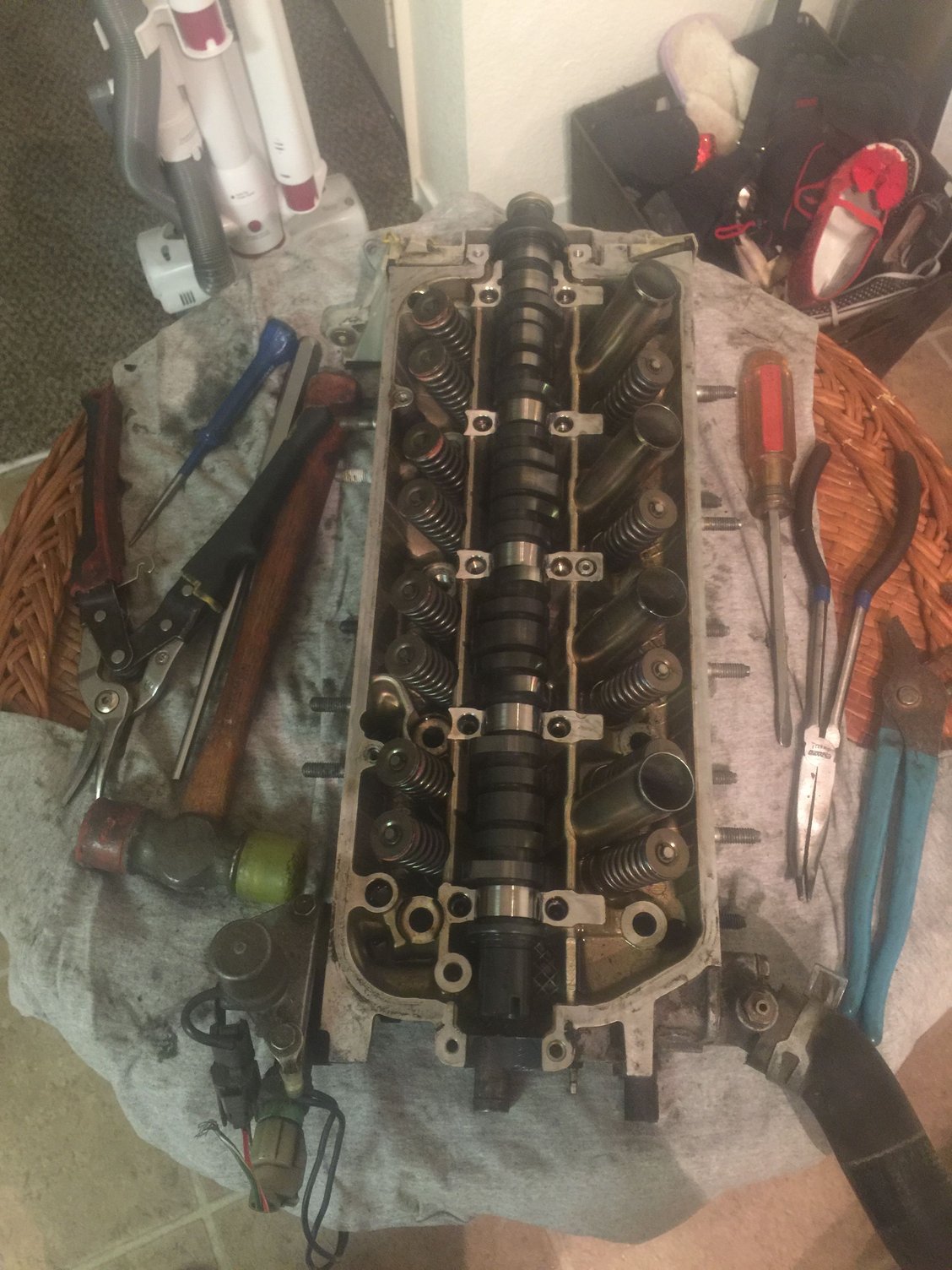

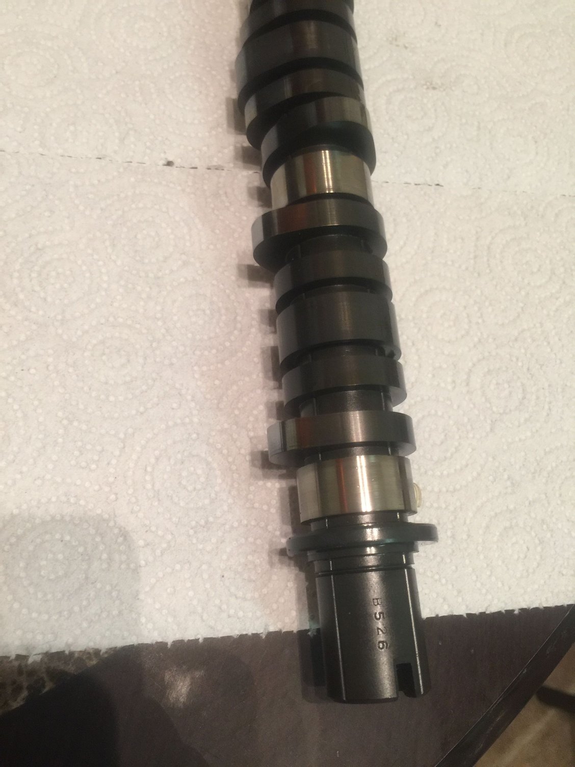

Yes I figured it out, the sst chip in the ecu was in the wrong way. I got it running but I'm having trouble with timing now. I have a y8 can gear to compensate for the half tooth off difference, but I can't get it right. I was told it had a stage two aftermarket camshaft, but after some research I believe it is just a jdm cam. I still can't figure what head the cam is for, I've look at related threads but nothing has the same stamps. On the dizzy side of the cam it has B526 stamped on it. It would help to know what head the cam belongs too d15b,z6,y8 etc.
