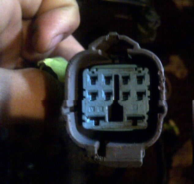

For be sure check your old distributor in the top bolt base.
https://honda-tech.com/attachment.ph...1&d=1396446897
Your harness has to have this plug? Right.
https://honda-tech.com/attachment.ph...2&d=1332713302

Idk about the numbers but the plug is the same...i had to give it to them for a core. I'm sure its just a bad dizzy. What I get for getting it at auto zone. Life time warranty is the only reason why I did...
