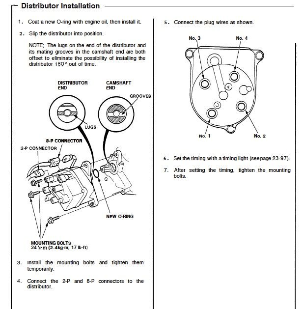

I think I'm just going to buy a new distributor with everything on it today. I found it for $50 online

Replacing the whole distributor would rule out a lot of stuff.

I replaced the distributor after about a week of letting the car sit without a distributor and engine cover on. Now when I try to turn the car over it barely cranks if it all. Also I don't hear the fuel pump prime anymore. It did both just last time I was working on it. Can anybody think of any connections to all this that a simple thing could fix?
