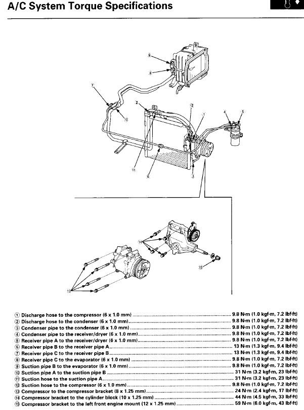

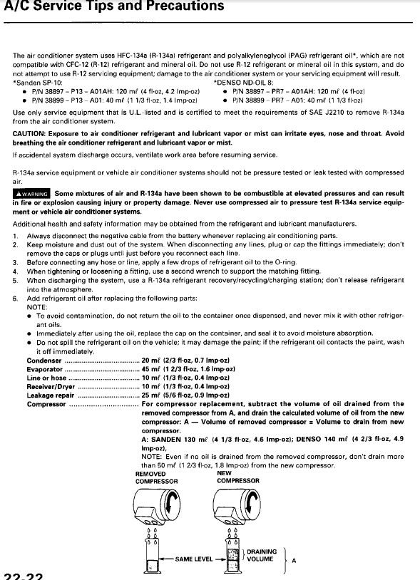

If you plan to do the job yourself, get the 96-00 Civic service manual. A google search will yield a free download.
Service manual page examples:
