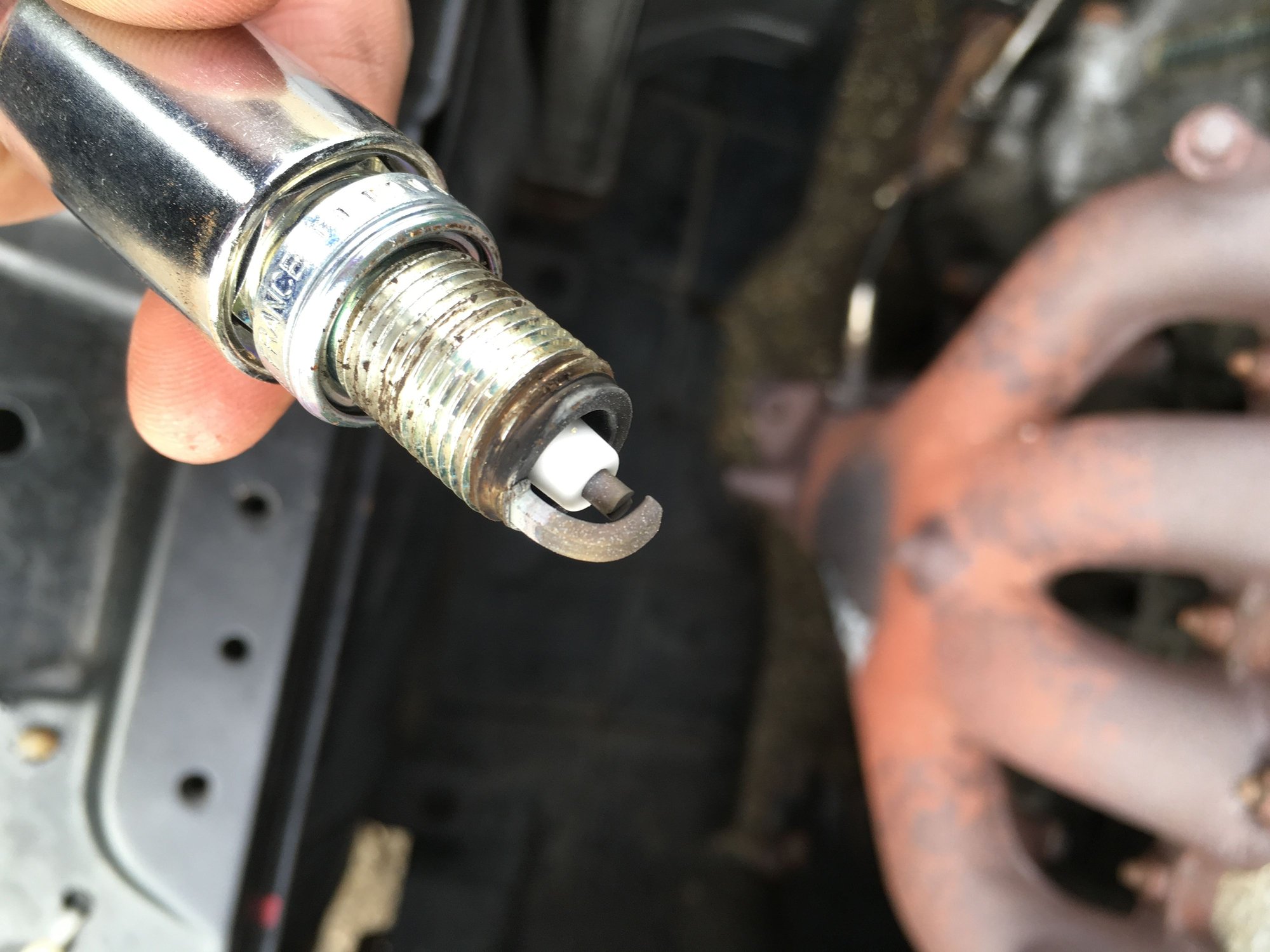

Checked sparkplugs, were good and a Nice brownish color but changed them anyway.

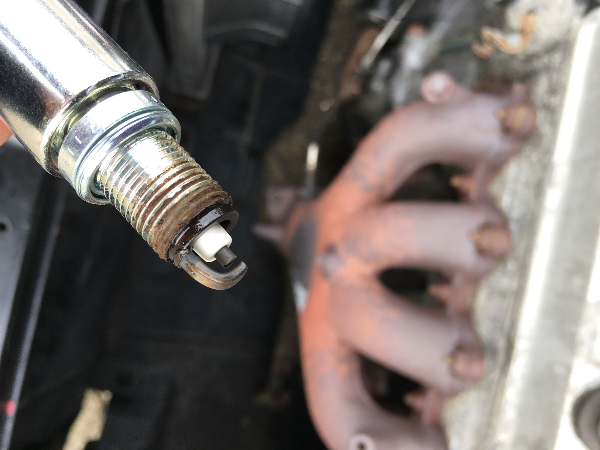

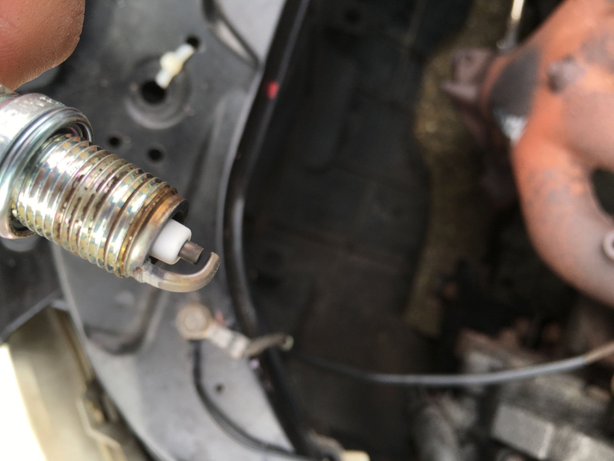

Photo of the spark plugs looks normal to me, only 1 has a bit of oil on it as you can see!

Seeing the oil on #3 and it's on the thread side of the plug only, nothing on the piston side, says you might have a valve seal problem on that cylinder.
That also correlates to only seeing smoke after stopping and idling a touch and then giving her gas to take off.
I probably wouldn't worry about it as these cars can burn serious amounts of oil and not skip a beat. Your emissions may be the only area of challenge depending.

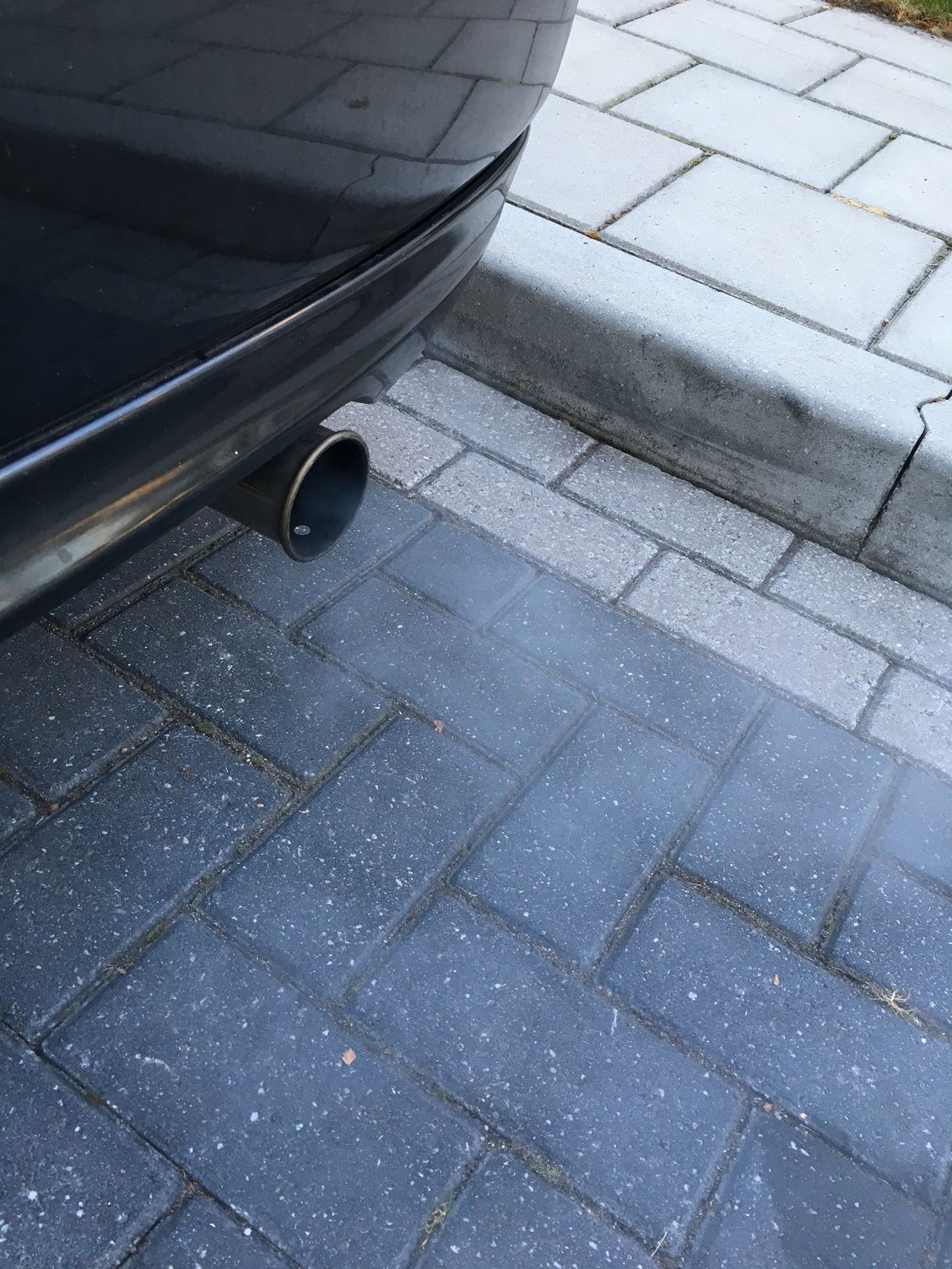

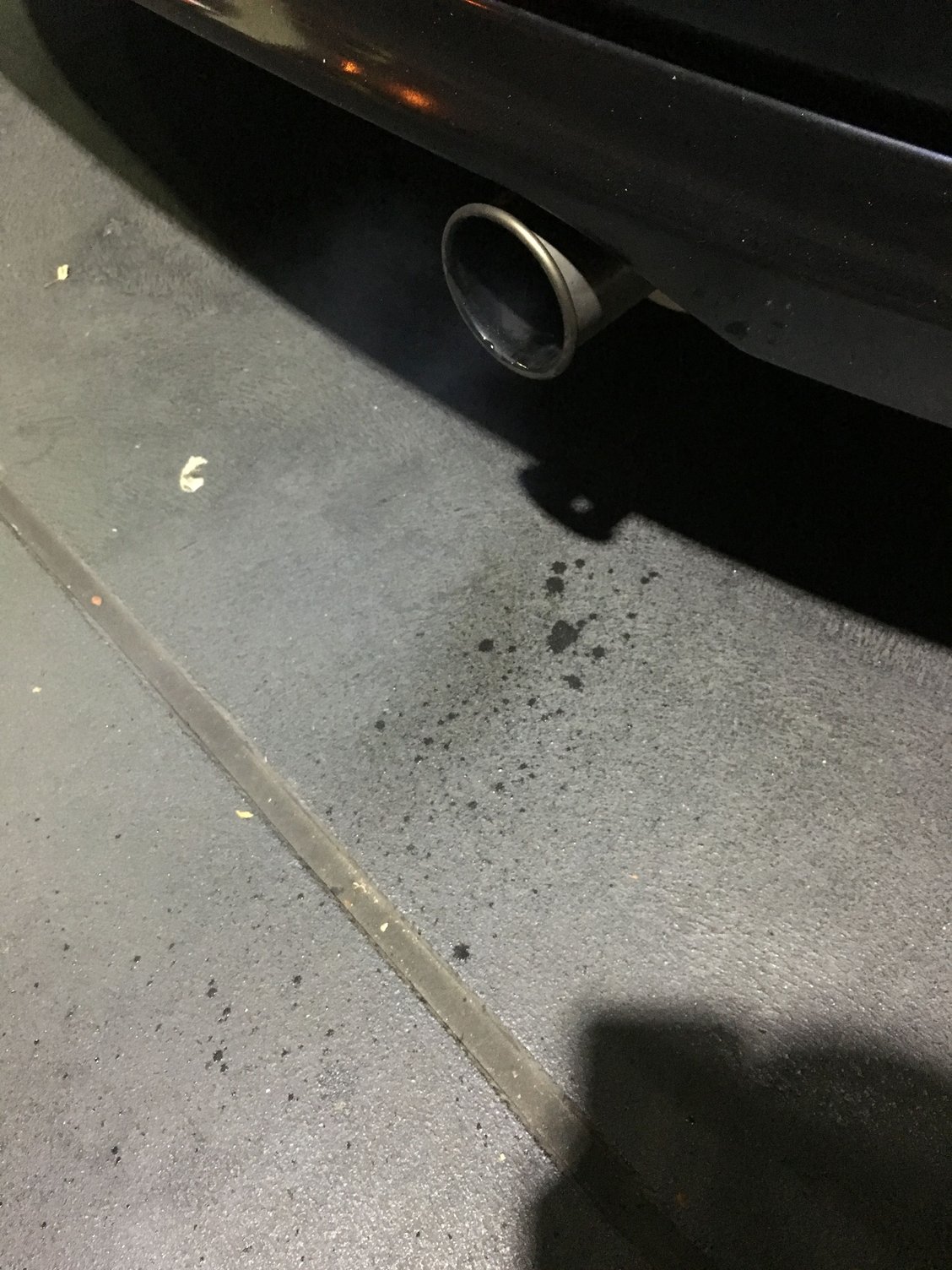

Maybe this is more helpfull? The first 1 is taken in the evening and stopped @ tank station after startup.
other 2 are in the morning when I just parked the car and let it idle..
That's the only time I can see smoke.. If I drive away.. Then you see nothing but when I Need to stop and wait you see it again.
