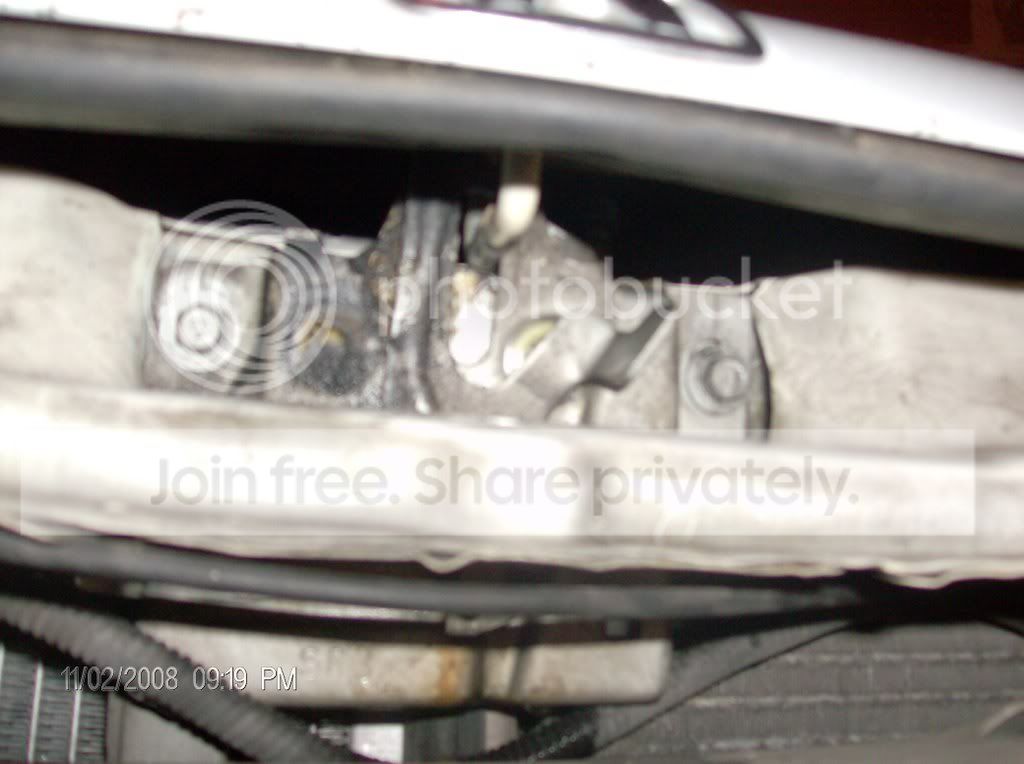

Latching shot
I went out and purchased a partial front clip from someone parting out a civic [thanks chris!]. It was chopped off and I took it home.
On to replacement. [This is where you guys come in] How do I go about tearing off my old frame bar and putting the new one on? The rail is spot welded. Do I drill out the spot welds then direct swap? Do I try and bend the old frame back up? If I decided to bend the frame back up, how do I go about doing it? Welding the new frame bar isn't a problem as my brother has a welder.

Latching shot

there is a lot of information all ready covered for replacing the radiator support. search it and i bet you come up with a lot of stuff. good luck!

you dont have to replace the rad support if your rad support is not bended badly..use some muscle get some bars and try to straightin it out..looks easy.. i did mine but mine was pushed back about and inch. i got oem jack and went great..

one of the best things to do (in my opinion) would be to bend back what you've got. My boss and i do this all the time with front end damage. for your current situation i would use a 4x4 piece of wood and a jack. once you jack the wheels off the ground then you or a friend could stand in the engine bay and give a little jump. or you could do the swao thing.

First things first, you need to take this car to a professional auto body repair shop. The radiator support is bent, good job on buying another one. The front bumper support should be replaced for safety reasons, also.
The latch mechanism that attach to the new hood should be replaced. if you can't close the hood, the mechanisms are likely, bent or broken. Even if not, it's not worth it to have the hood fly up or off while driving if you can somehow get it to work..
Also, another reason to take it to an auto body repair shop is the front end if probably out of whack... Things won't always line up til you get your frame aligned and such. You need a spot welder, or you can spot weld with a regular MIG welder, but since you're asking, you obviously have VERY limited knowledge of auto body repair, so please, get this fixed at an auto body shop. Bending back damaged parts is one of the stupidest and dumbass ideas, don't do it. Why? The metal structure is already weakened, and by bending the structure back, you're weakening it further. The strength of the metal is compromised, and in the next accident you or another person gets into with the car, you could be seriously hurt.

I understand a lot of what you say. I'm not a complete idiot though. I don't plan on doing things half ***. If you scroll up and look I purchased a new radiator support. I was more asking on how exactly I should go about taking the old bent one off and putting the new one on. I do have a new hood latch. The old one latched just fine, it just required spacers. As for the previous owner not repairing it, its wasnt a SERIOUS accident. He just bumped into a truck/suv. I picked this up from a used car lot. I'm pretty sure that is COMPLETELY irrelevant, but the frame isnt bent. Just the radiator support is. I don't roll around with a hood that does not close. I have seen horror stories from people who have. I do not drive my car unless I feel it is safe to. My brother owns a spot welder at his shop. He is going to help me replace it. I will be doing this professionally assisted. Rest assured things will be fine. Though I appreciate your concern.

if you read my whole post, you'd see I recognized the fact that you got another support. Fact is, it should be done professionally. Obviously you disagree, so I can't really help further. Good luck.
