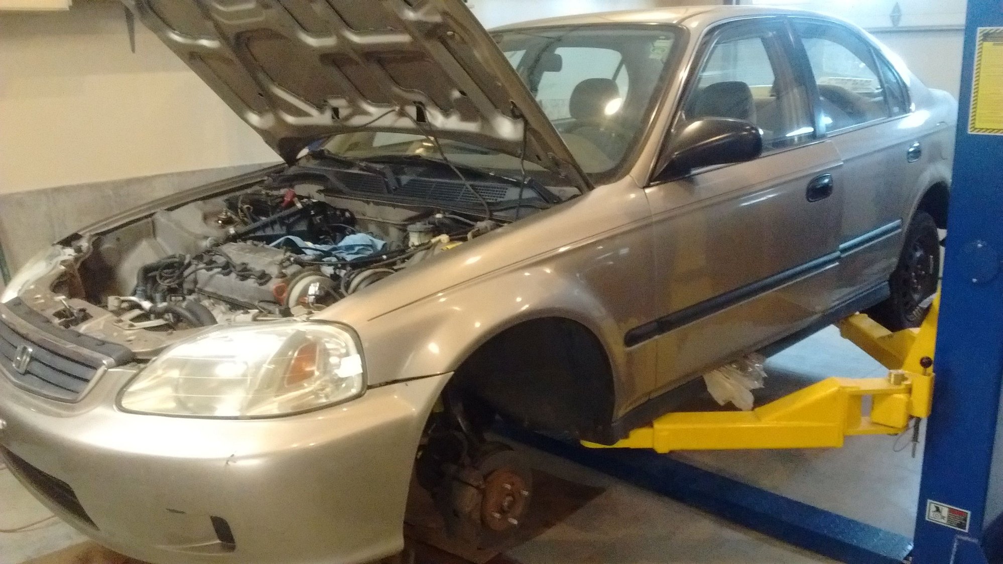

I have all the bolts on the rear suspension loose. Except one. I broke the passenger side lower control arm bolt the connects to the trailing arm at the knuckle. I cut the bushing out, heated the bolt, pb blasted it, and tried a bolt extractor. The threads are really stuck. I am afraid that if I keep drilling I will mess up the threads on the knuckle.
Is there any reason I can't drill out the trailing arm all the way through. This way I can use a bolt and a nut instead of the factory welded on threaded part.

Post some pictures if possible.

Here is the car. Its getting a lot more work than its worth. It should run for a good long time though.
This is the passenger side lower control arm to knuckle. The lower nut is the where I knocked off the welded on "nut" and replaced with a hex nut. The top is the strut.
This is the original welded nut on the passenger side knuckle.
