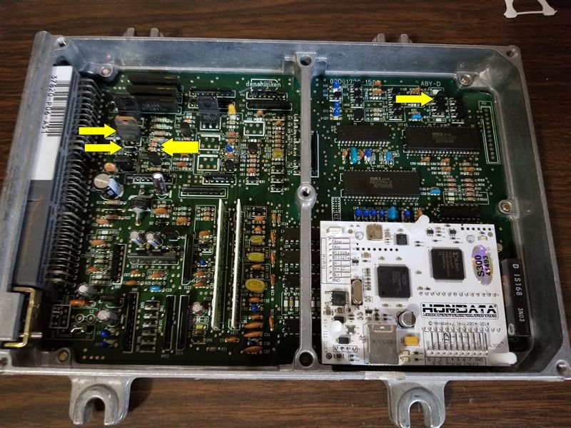

Last but not least, Amazon finally got my new soldering iron to me so I got the boost control components soldered into my ECU. It's only a total of 5 components (2 transistors, 2 resistors and a diode) and took me about 30 minutes from start to finish to get done.
