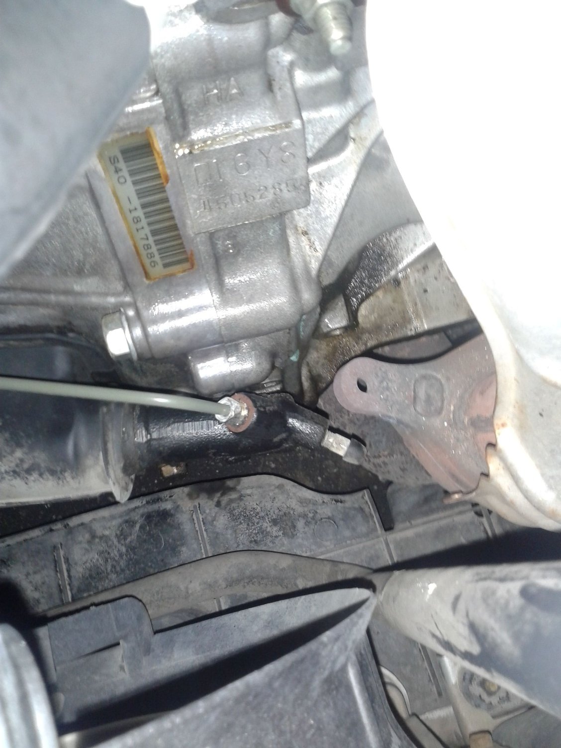

Here are the pictures sorry for the time I took to post them I got real busy.
I cleaned the engine where the oil was seeping through and it was bone dry until I checked it again today and it is leaking in the same place like around the distributor area any ideas what it could be? I barely changed the oil a week prior when I noticed the leaking.
P.s Thanks for the help I really appreciate it!

Looks like it could be the o-ring inside the distributor. Super easy fix.

Take the distributor cap off and check inside for oil. If dry change the distributor to cylinder head o-ring. If wet you will need to change both. The inside o-ring requires dis-assembly of the distributor.

I took the distributor off and noticed it didn't have the o ring so I put the new o ring on and i drove the car and i checked it two days after and its still leaking around that area shown in the pictures, what else can it be?

Check the VTEC solenoid.

Grr So I was wrong I thought the leak had stopped but it is still leaking from the same spot which Is shwn in the pictures, I did the valve cover gasket and distributor anything else It Could Be?

Maybe the o ring behind the distributor

This might sound dumb but do I remove the solenoid and check or how would I check because I looked and I don't think it's leaking.

A leak there can be difficult to see. Carefully swipe your fingers across the bottom of the solenoid. Any oil on your fingers?

Sounds like the vtec solenoid, it will throw you off the way it leaks

Vtec Gasket.. apply hondabond to entire snowman gasket..do not get hondabond on oil screen or inside Vtec solenoid
