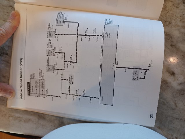

The VSS signal out splits into two wires about a foot before reaching the ECU... so one wire goes to the ECU and the other goes up to the instrument cluster to drive the speedometer/odometer. You have stated that the odometer works suggests that the signal wire is good... so the speedometer itself is the culprit. This may also be the reason that the trip odometer isn't functioning.

tx i got a copy of the del sol electricak troubleshooting manual. vss goes 4 placesinstrument cluster, roof interlock,. engine control unit and cuise control unit page 33 and 33-1 of manual. so i agree with you, if my OBD-1 is reading the speed from the ecu the VSS is working. i need to double check if the cruise is good or not. cruise was working prior to the speedo issue. hopefulully it still works, i have no idea why the vss feeds into the roof interlock circuit
