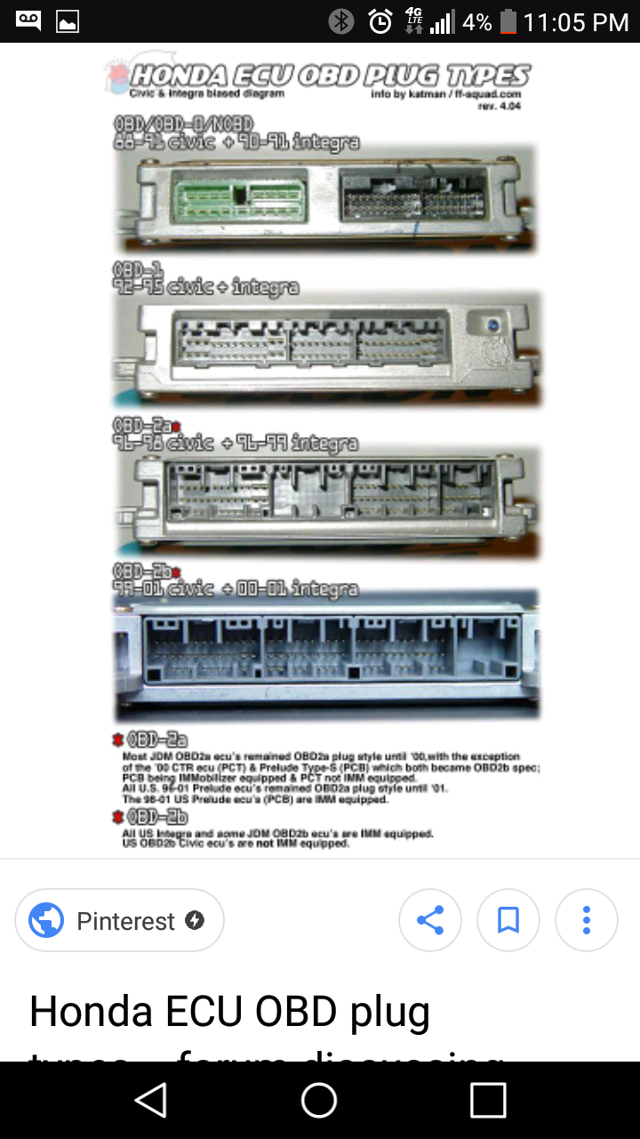

My actual ecu
Mine looks like 3rd one down.

Now my question is can i cut the plug for the ckf and wire in to the dizzy instead of splicing at the ecu. ( can i tie in to the ckp) if so how do i do that what two wires do i use to make this connection. The white one the ckf would go to? And the blue wires would go?.
please if anyone has done this please let me know.
by the way i have a p28 obd2.
