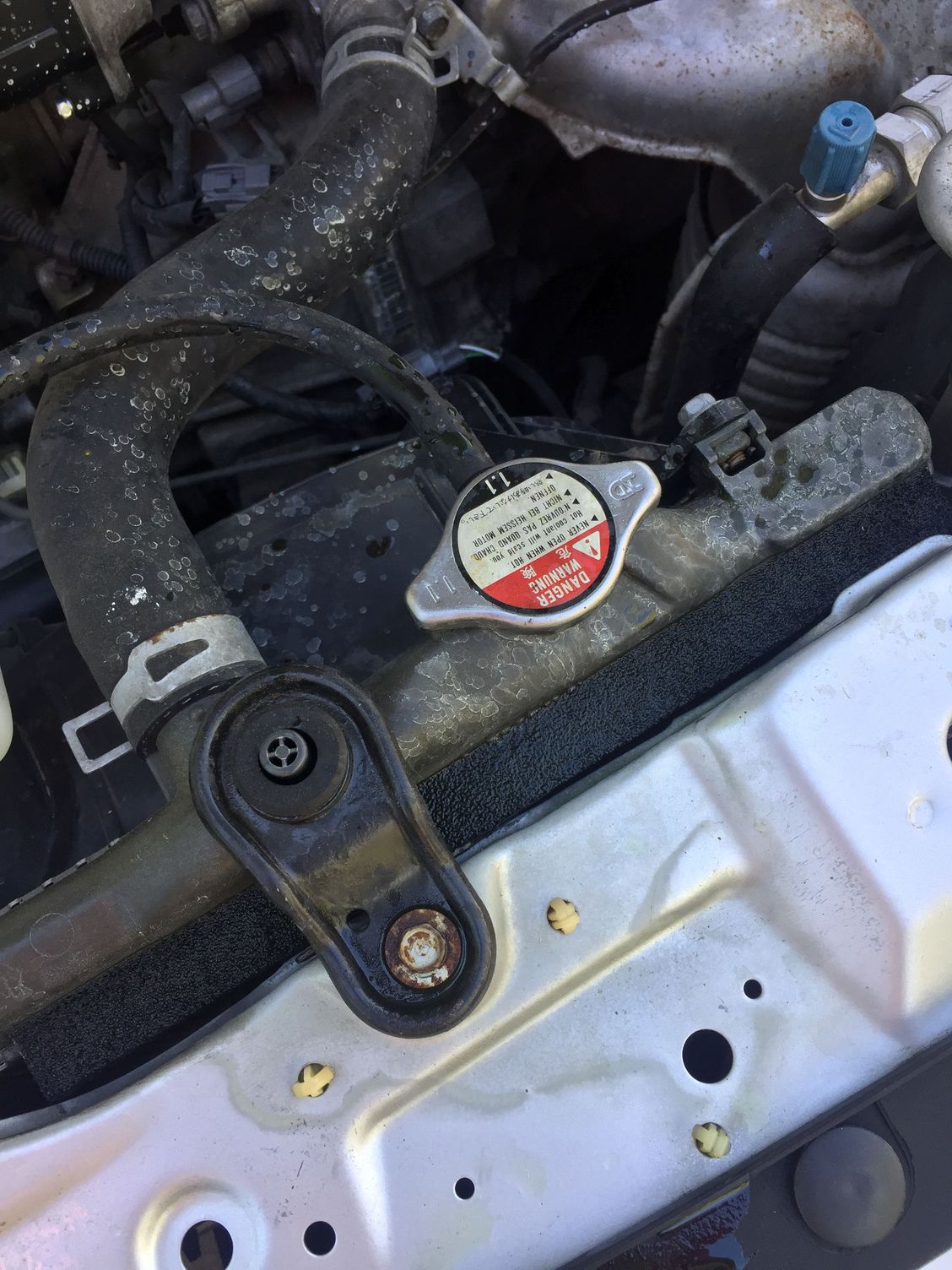

So I went on a 2 hour trip to a junkyard today looking for a gauge cluster.
on the way the first 20 minutes I could hear slight chirping as before from the same side only when above 55mph. It did not change or increase with speed and acceleration or depressing the clutch.
after 20 minutes or so, it went away and didn't come back at all. Then right when I was getting home the temp gauge went all the way up and there was coolant all over the engine bay when I got home, and the sponge by the radiator cap was soaked in coolant. Pretty sure there's a crack near the seam by the radiator cap under the sponge in this picture
Should I go OEM or aftermarket for a new radiator? And if aftermarket which brand?
also when replacing the radiator is it as simple as unplugging and draining the radiator and then putting the new one in and connecting the hoses and fill it up? Do any of the transmission hoses flow through the radiator?
Sevas is offline   Reply With Quote

Are you certain its the radiator itself and not the cap gone bad? Check the cap for the inner seal crack. If you must replace the radiator, oem, mishimoto, koyo. Oem radiator cap. If your car is auto then you will have tranny fluid cooling hoses attached to the lower portion of the radiator. You must disconnect them prior. Drain, Uninstall, replace, fill coolant, bleed air out. Take your time. Its easy. U must bleed the air out completely, its important.
civic402lx is offline   Reply With Quote
ive a manual tranny so will I not have any tranny fluid flowing through the radiator?
and I'll check the cap. Now that I think about it that spongy strip is pretty wet/moist most the time when I check but idk why I never thought anything of it. I'll double check today, how can I check the cap

You can check the cap simply by looking at the gasket surfaces. As for the radiator ive had great success with my "no name" Aluminum dual core half rad from ebay, and it only cost me about $100 shipped!
96-00 Honda Civic EK EM 2/3/4 door Aluminum Radiator MT Manual Trans + Black Fan
I got one the same as that but mine did not come with a fan.
AdrianClayton is offline   Reply With Quote

So I replaced the radiator with one I ordered through denso.
