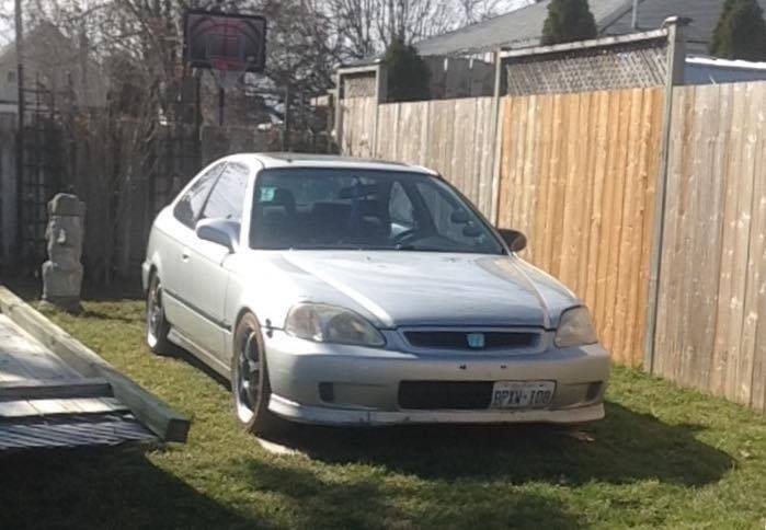

So starting off I'm new to the Civic world and this is my first Honda. Aswell I've not had a ton of experience doing anything on cars, and am planning to learn as I go to keep this civic running as long as I can

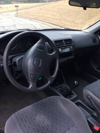

The Car: after weeks of searching for the perfect car, I stumbled upon a post of an almost 100% stock 99 Dx Coupe that had only one previous owner, and she had just retired so no longer needed a commute vehicle for work. It has 185k miles, and I got it for $1780. I'm not sure my goals with the car, it's going to be my daily, but I want it to look cool and learn about cars and engine work.
Before:

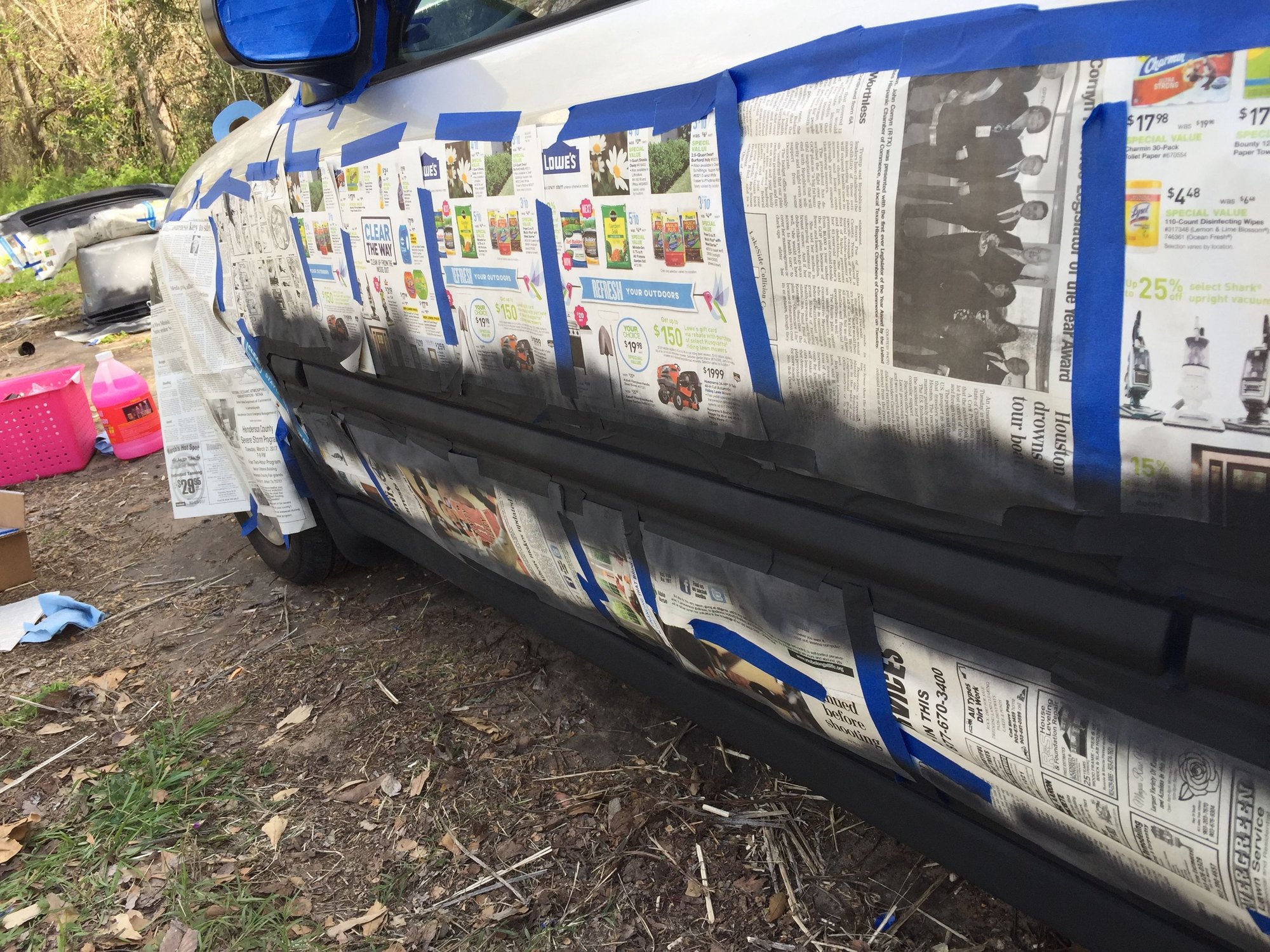

The interior was extremely clean and the engine bay was pretty gunked up, so I decided to have a go at cleaning it up and making it look nicer.

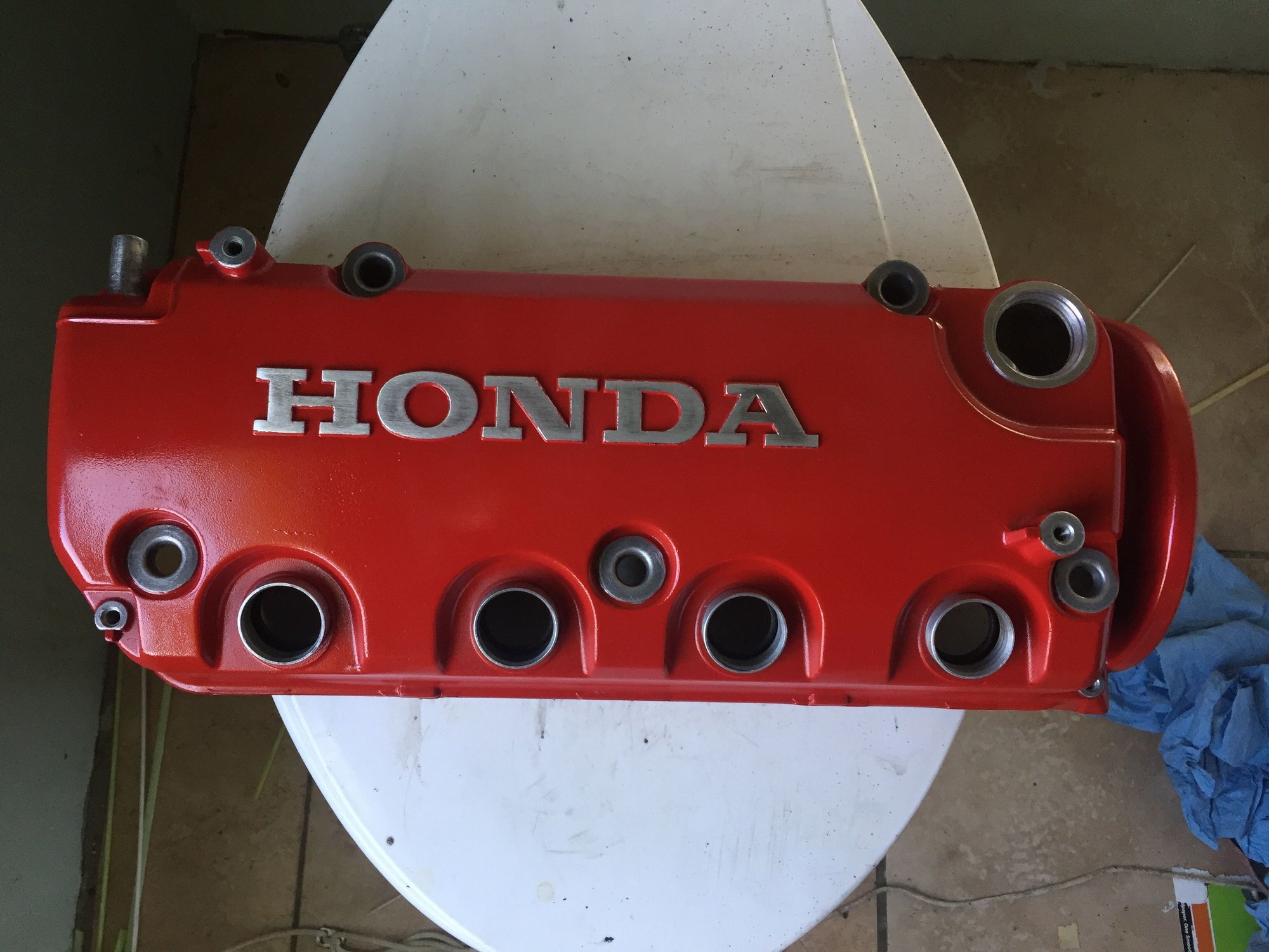

After cleaning, painting the valve cover.
First time every actually taking off a valve cover, was actually really fun!
Took forever to sand this thing down

Had to free time this weekend so I decided to swap out a few things and clean the car up a bit
replaced the plug wires with NGK blue performance wires, changed out the brake pads and rotors and swapped off the janky air intake for a better one and new filter.
also decided to paint up all the black plastic trim on the car since it was all very faded.
pictures:
Took off the grill and bumper, man I love this car.
You can see how faded some of the black plastics were.
Didn't seem like there was a way to remove the black plastic parts from the bumper so I had to tape the whole thing off.
Wish I would have taken a before pic of the side skirts as they were super faded.

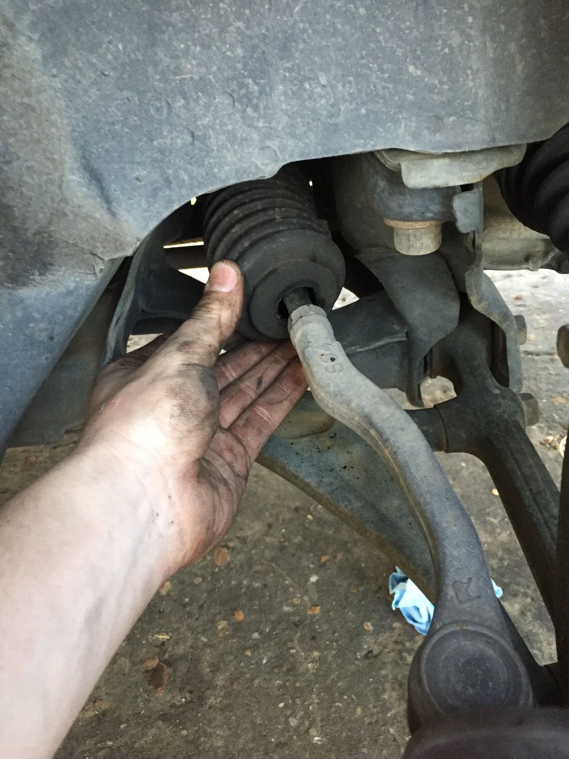

Not sure if the joint is bad on this but noticed both boots on both sides were damaged.
Should I replace the joints or just the boots?

All cleaned up! With black plastics restored!
