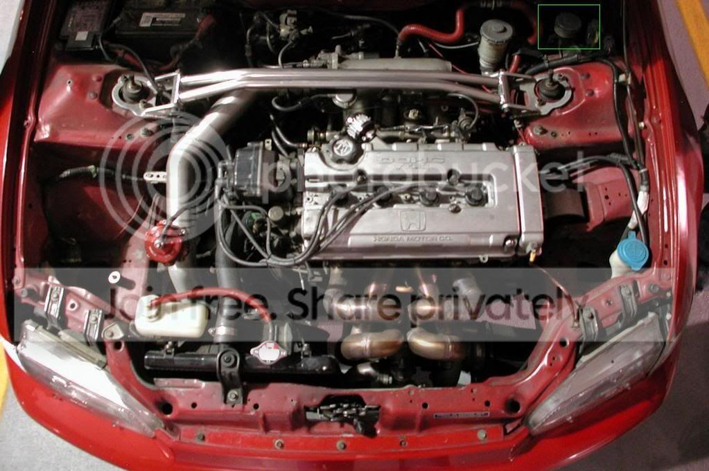

That thing circled in green is the clutch fluid reservoir. It sits on top of the clutch master cylinder. You get to just swap that entire assembly out (it attaches to the lever on the clutch pedal) and put it back on (re-tighten the clutch lines), then bleed the clutch like you would your brakes).

In any event, you said that you don't know much about cars, etc. etc.
