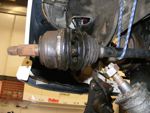

While maneuvering around the driver side axle to get better views of how it is looking, we notice that the subframe bolt on my lower control arm isn’t screwed in all the way? WTF! no bueno…..after much confusion, and lengthy inspection, we realize that the weld inside of the control arm broke off and the receiving bung for the bolt is broken. NOT ******* GOOD this is a SERIOUS safety issue….this bolt being broke and loose allowed my control arm to travel too far and my suspension on my driver to side to get all fcuked outta wack…..SO…..we had to cut a 1” hole in the bottom of the control arm to get the bung back and to be able to repair. We were able to drop the piece out of the arm, weld it back to inside of the control arm to fit. All that is left now is to cover the hole that we made in lower part of the control arm. Not so much as a new piece, but 3 hours later a huge headache, and major disappointment, we move on……..

2. Driver side Axle Boot

here is my axle boot that was obviously shot....

axle boot
