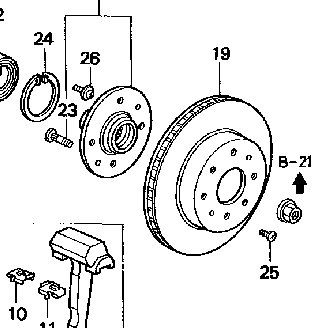

Well, for my 97 LX, Honda calls them Bolt, Wheel - either P/N 90113-SA0-025 or 90113-SM1-005 - cost 3.39 and 1.11 respectively. Item 23 in this picture.
No idea if the p/n is right for your model/year combo, though, so it's probably worth checking out further.
