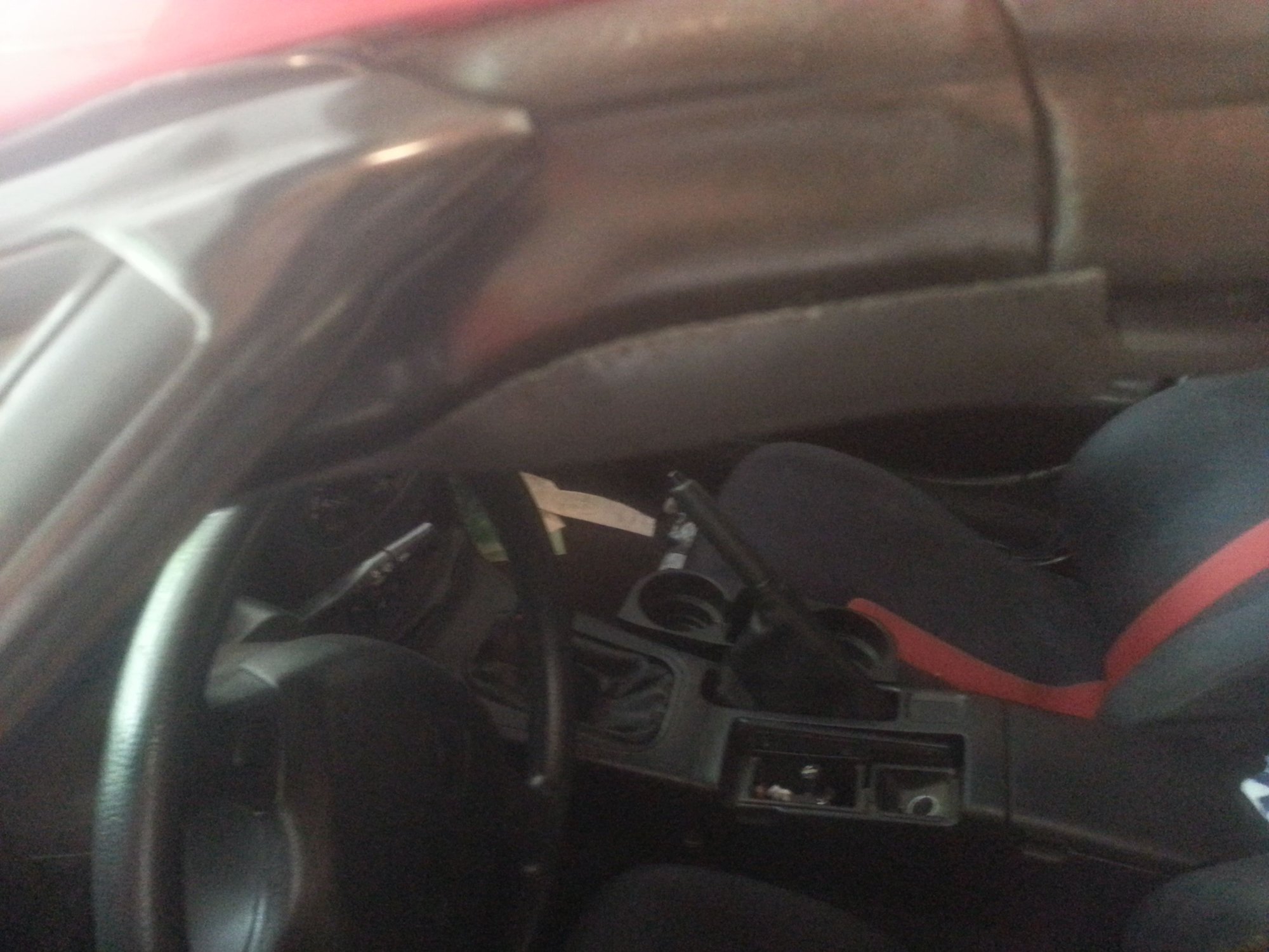

S models came with drum brakes in back, so, that's a way to tell too, besides looking up the VIN of course lol.
Cool then! Change all the fluids, and check the pads n rotors, and she should be good to go! My dad's would have gone well over 300k on his Z6 if the exhaust manifold hadn't cracked and burned a valve out, so it should last her a while with a lil maintenance.
OH, and change the front door to door gasket if its the smooth type. Its a design flaw and it will leak like a sieve in the rain! Honda Automotive Parts #6.
If they look newish, and have a lil wing like flap at the top front corners of the doors then its been done already and don't need to worry about it.

Well they both have disc brakes in the back. And I think the molding is the new stuff, but I can't tell really with out seeing what both look like 😐.

Yeah, the old kind has a lil flap, but the new is larger..
Mine was from a junk car, dads is new. They started using these in 95+, but never recalled the older ones, even tho they knew it was a design flaw.. heh.
