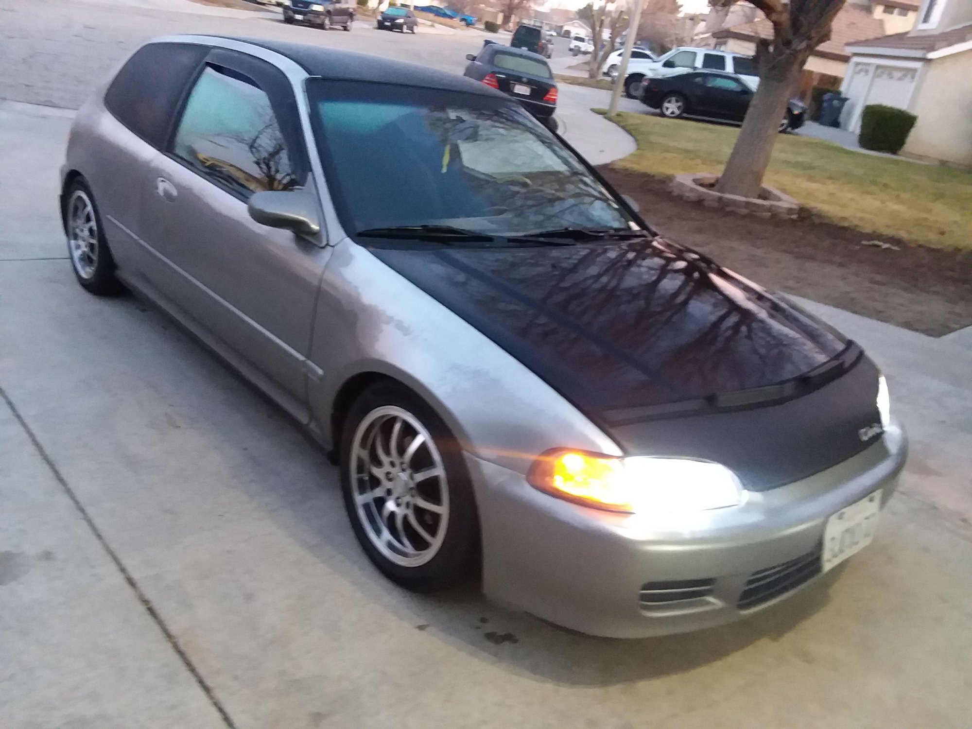

Hi everyone, I tried searching the threads but couldn't find anything same with the google. 1992 civic dx 1.5 non-vtec Automatic
Here's my issue, Ive had the car over a year now and just recently it has been leaving me stranded a few times. The first time it happened I was driving like normal, nothing crazy (its an automatic) when all of a sudden i notice the RPM's dropped and car shuts off. Almost as i had turned the key off. Radio was on all lights where on and everything normal. It was just the engine that tuned off on me. Luckily i was able to coast off enough to get on the shoulder safely.
I turned the key back and tried to turn it on (tried several times), all i got was the engine cranking but not able to turn it over. looking under the hood there was nothing out of the ordinary everything looked good, i didnt know what to do. I end up calling for someone to pick me up and while i was waiting i figured to try it one more time ( about 15 minutes had passed by at this point) and boom the car turned on as if nothing was wrong and i was on my way again, straight home.
trouble shooting/Replicating the issue
-normal driving (turns off maybe after 30min sometimes not at all)
-while driving accelerate as to pass a car (more than often this is when it shuts off)
-letting the car run on idle on the driveway (maybe after 30 minutes sometimes longer, it starts to spurt and shuts off ) <im guessing fuel>
In all of these occasions, the car would not start back up unless i let it sit for a couple minutes to an hour.
Things i've done since
-new fuel relay switch
-spark plugs /cables/dizzy cap
-fuel filter
-timing belt & water pump (why not, i was already there.
-thermostat
Lately
Exhaust fumes smell a little rich. Maybe its not having full combustion of the mixture.
Future plans
-New fuel pump
-new distributor
I have to pass smog this year and taking it to do the test only the tech said it was producing too many emissions and wouldnt pass 2-3 test that are required in Cali.
Any help would be awesome guys, maybe someone has had this issue or a better understanding of what it may be that is causing this for me and point me into that direction
Thanks everyone

Good looking hatch, by the way.
