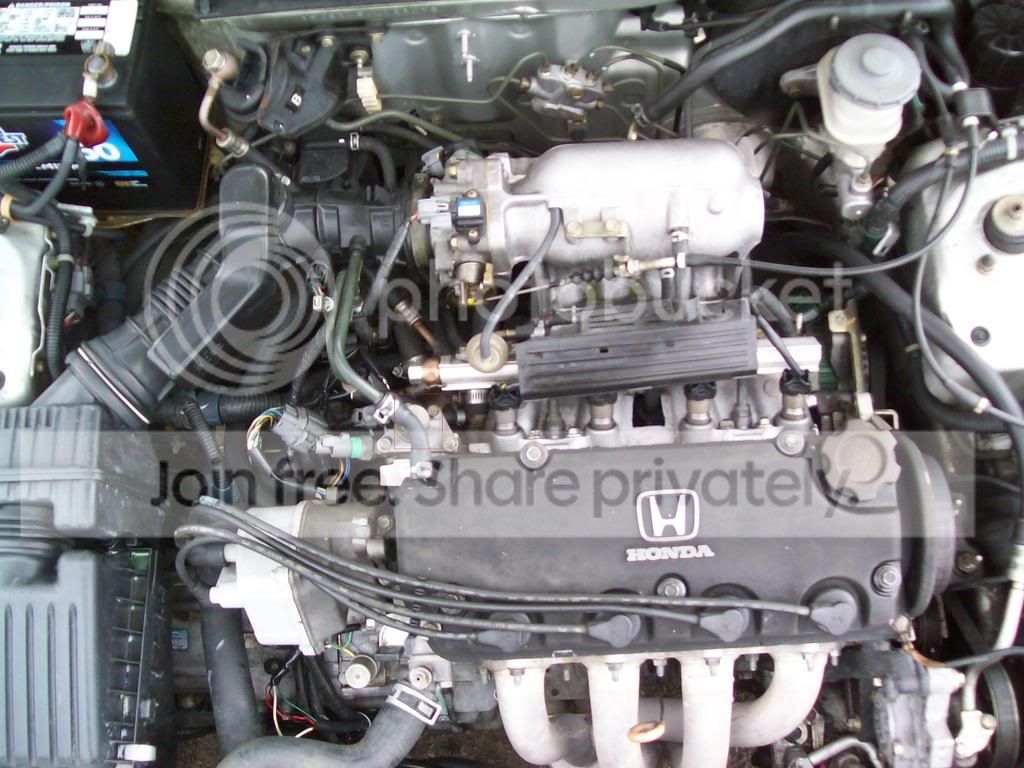

JDMPHILEP91's Avatar
Join Date: Jun 2008
Location: NATIONAL CITY, CALI
Posts: 83
Default Re: (NOFX)
heres a picture of a d16z6 that does not say vtec..but you could tell by the solenoid that is in the red square...in the pic below.

thx bro that helps, ok that answers the question so Ive got a baby vtec lil 1.6

baller status's Avatar
Join Date: Nov 2007
Location: Western Hemisphere
Posts: 655
Default Re: (JDMPHILEP91)
<TABLE WIDTH="90%" CELLSPACING=0 CELLPADDING=0 ALIGN=CENTER><TR><TD>Quote, originally posted by JDMPHILEP91 &raquo;</TD></TR><TR><TD CLASS="quote">heres a picture of a d16z6 that does not say vtec..but you could tell by the solenoid that is in the red square...in the pic below.
That's not a D16Z6, it's a D16Y8 and it's in an EK chassis.
The 94-95 valve covers say "VTEC" and the 96+ all just say "Honda". But I wouldn't use the valve cover as a reliable indication of anything as many of them are interchangeable between the various VTEC and even non-VTEC SOHC motors.
btw what's up with the coolant on the webbing between the intake runners?
Hm. Also appears to have an auto trans on it.
