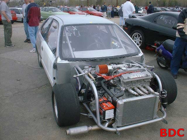

Nice worms! Makes more sense than having all that **** hanging down below the engine IMHO...

They love being above 5500 rpm. They dont hurt low-end, just shine up high...
Hrm... I wouldn't bet on that.
In nearly all non-turbo header designs, there is an intent to keep the length of each tube identical. That's what they have done here. There is a great deal of science around proper header design, but like most other engine design choices - header design is a matter of compromise[s]. In this case, you lose your A/C.
Sure, the length of the tubes and diameter of the tubes as well as the collector can be varied to optimize torque and HP at different RPM ranges, but NO header design works equally well in ALL RPM ranges. That's why Honda doesn't put collector-style tube headers on their factory cars, certain ITR's excepted. They use a Tri-Y design which is MUCH better for low-end power.
Just looking at this collector-style racing pipe with its matched primary lengths and so forth, and knowing what I know about headers with collectors, I would say the lower-end would have to suffer somewhat. Guess we'll find out when the dyno charts come out. Maybe they've pre-empted the laws of physics somehow, but I doubt it...

Default Re: I recommend against purchasing AN-R products.... (Soulless)
what is up with this??? is that a real header?? strange lookin!!...
The header on the blue car is another AN-R design. It comes in either standard or side discharge (which is cool on racecars with tube frames and so forth).
The one on the blue car would be considered the 'standard' AN-R header most ppl would buy; B-series, H-series, D-series. The one with the ming worms is for B-series engines only in an EG/DC/EF chassis...
