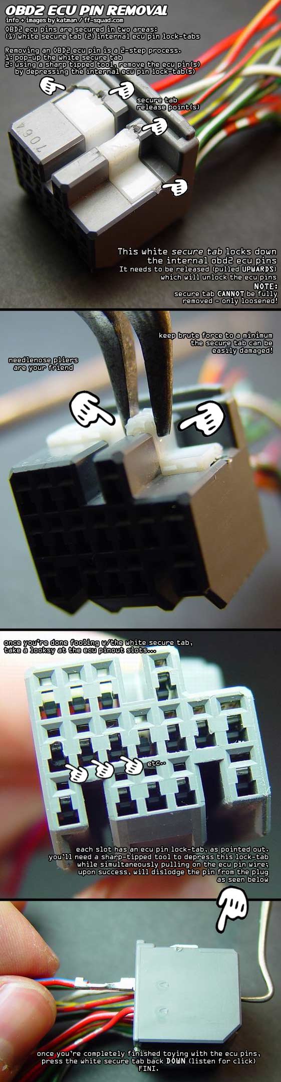

guys i did the minime a while ago but every time i try to put the obd2 pin in the ecu socket it only gets half way through, any tips on how to get them in there?

thanks man!
katman hooked me up with this
